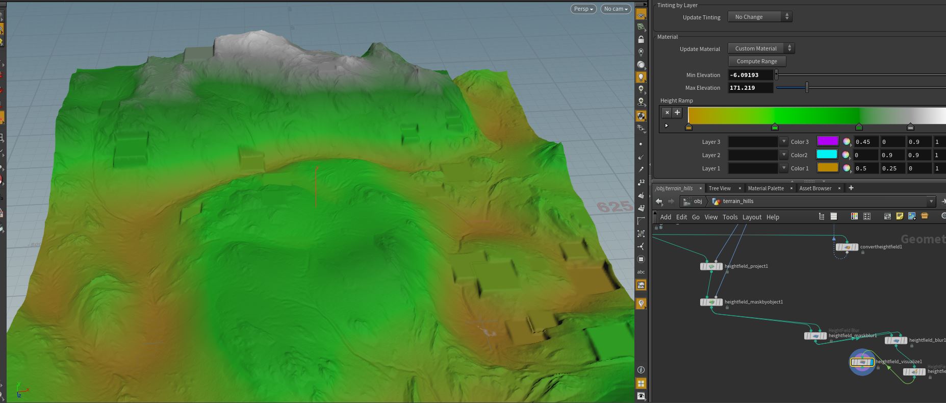

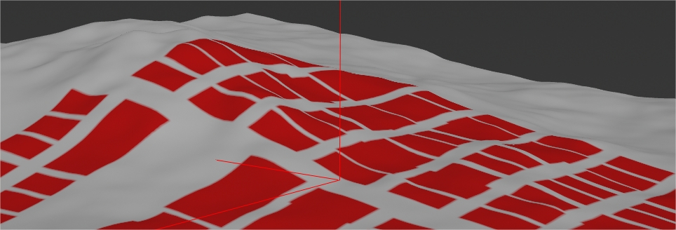

I'm using the new terrain heightfields operators and I want to flatten the terrain where I want to place buildings. I use the Mask by Object operator to mask to location where buildings will be placed.
The effect I try to acheive is the every contiguous patch of red (mask) on the terrain would be flattened using it's local center.
I tried using a for loop to loop on the primitives in the input Mask by Object but then I can't get the average height of each masked out sections in a voxel.
How would I go about flattening each of my masked out areas by using their local average?
Thx!
Christian
Thx!
Christian
