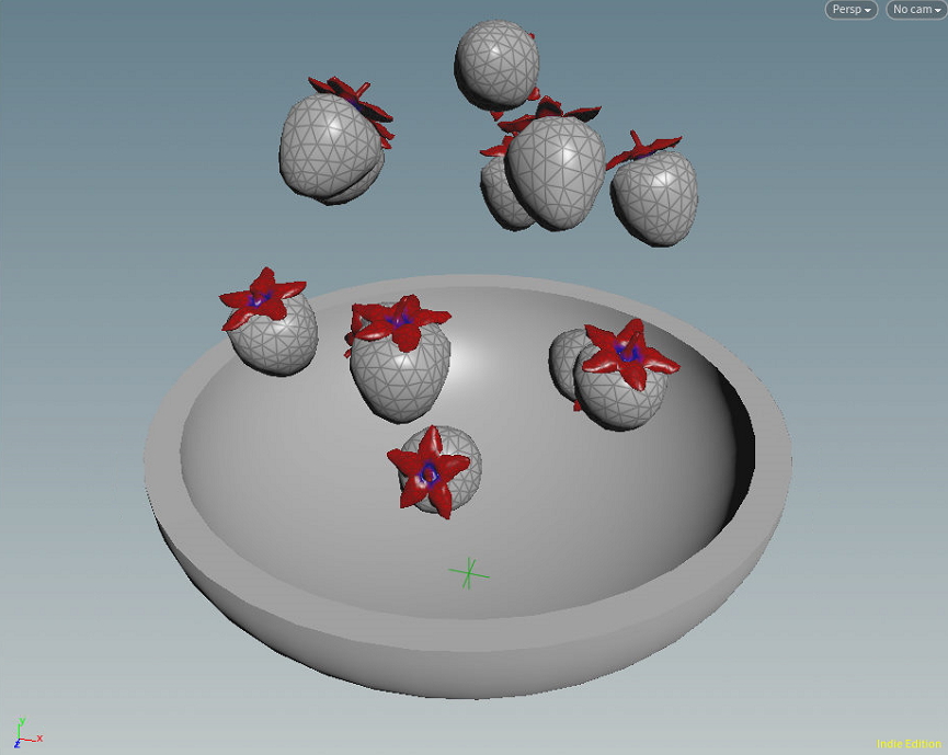

Hi Guys,
Im trying to setup a scene here using strawberries (body and leaves) to fall dinamically. So I am simulating the body with FEM, and the leaves with Cloth. They collide with each other but I cant seem to constrain the leaves to its respective body. I managed to paint the leaves where I need the constrain to act by proximity (attrib blend Cd), So I need to PIN these point to its body (which I have to find also by proximity).
Does houdini have a pin constrain Point to Point? How would you approach this? Thank you!
This is what i have right now VIDEO : https://www.dropbox.com/s/dn2ozugpk9zl2j2/video-1493247667.mp4?dl=0 [dropbox.com]

You should be able to use the Cloth Stitch Constraint for this purpose.
