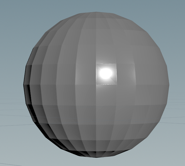

but the problem still not be solved . i also cannot get the low poly sphere look like high ploy shpere .
1, i create the princip material .
2 ,in the bump& normal tab ,click enable,and add the Nt map texture just baked .then assign to the low ploy sphere. the sphere also look like nothing happen as below picture show.
