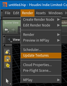

Hi, when you overwrite the file from photoshop, does it error out or show any dialogs that tells you overwriting the file is forbidden?
If not, you could try the “Update Textures” menu command:
Use this after overwriting your file from photoshop.
