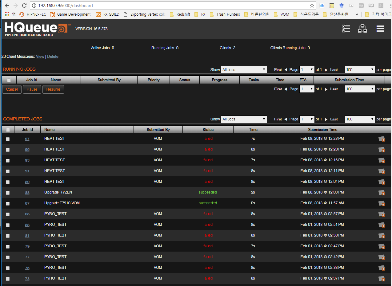

I am struggling days and days to setting up my local HQUEUE system.
My condition is
1. I Have 2 PCs one is HQUEUE SERVER and HOUDINI INDIE had installed. the other one is only HQUEUE CLIENT.
2. HQUEUE SERVER has installed and works fine.
3. When I use hq_sim node to submit a simulation through HQUEUE, SERVER PC's simulation job works fine.
4. BUT, When I submit a job to HQUEUE CLIENT PC, simulation works fail however server-client communication
or upgrade order is working.
5. failure log is “setting status to failed”
Could somebody help me to get things right?
Thank you in advance.
I'll attach my HQUEUE website.

Hello Rob, Thank you for your reply.
I'll attach my logs.
Job Diagnostic Information
Diagnostic Information for Job 104:
Job Name: Simulate -> HIP: 0208_scene.hiplc ROP: output (No Slices)
Submitted By: VOM
Job ID: 104
Parent Job ID(s): 103
Number of Clients Assigned: 1
Job Status: failed
Report Generated On: February 10, 2018 09:11:28 AM

- rvinluan
- 1495 posts
Hmm. I can see consistent errors in hqnode.log that point to the client machine failing to connect to the server. The failure doesn't happen all the time just intermittently.
It's almost as if the network becomes temporarily unreachable.
I have a couple of questions:
- Is the client machine reporting a heartbeat? i.e. check the Last Heartbeat column in the clients table on the HQueue web interface
- Is the client machine consistently failing jobs? And is HQueue consistently unable to find the job output file?
- Is the HQueue Client service running on the client machine? Or are you manually starting the client by running
Cheers,
Rob
