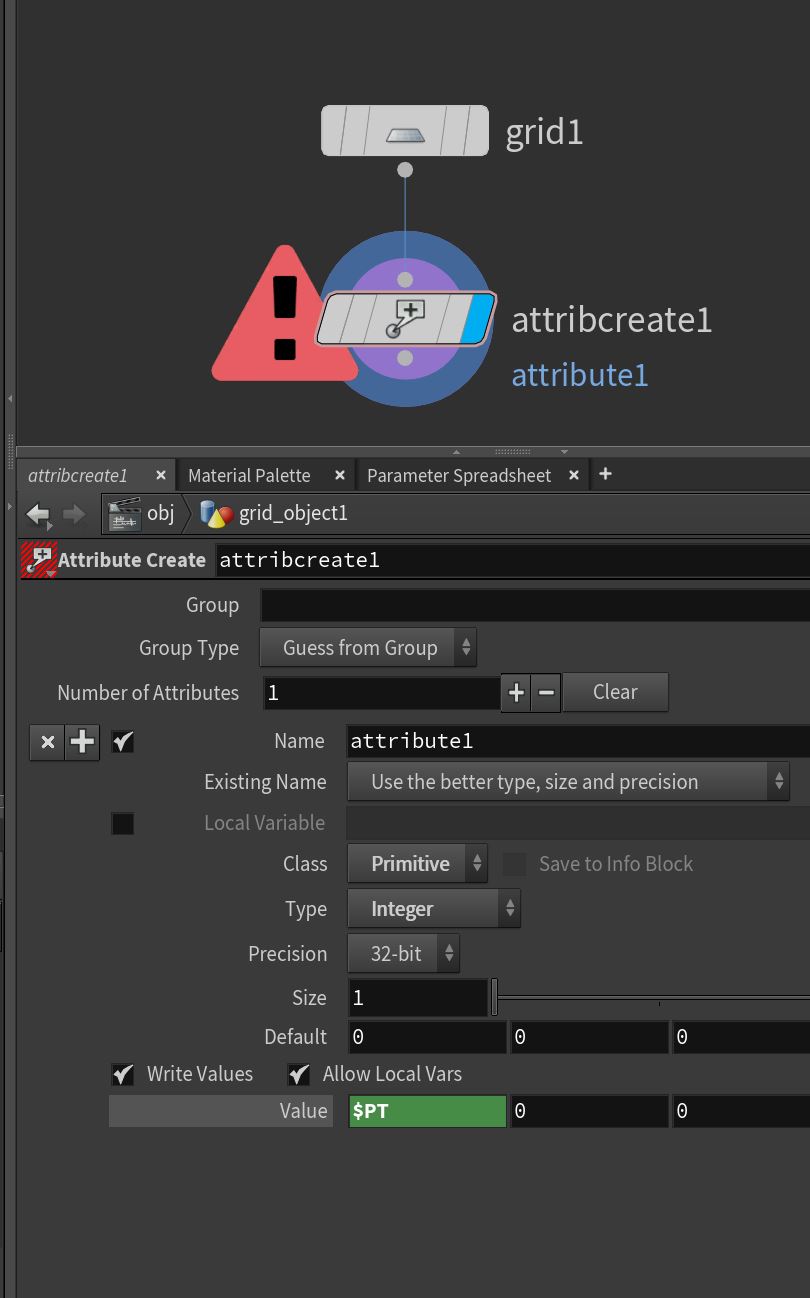

Hi;
I would like to get “primitive's number” as an attribute, so I used this method but it doesn't work.
I can't figure out what is wrong with my code:

Not completely clear on what you're trying to do, why not just use attribute wrangle set to run over points: i@prim = @primnum

You misspelled ‘PR’
