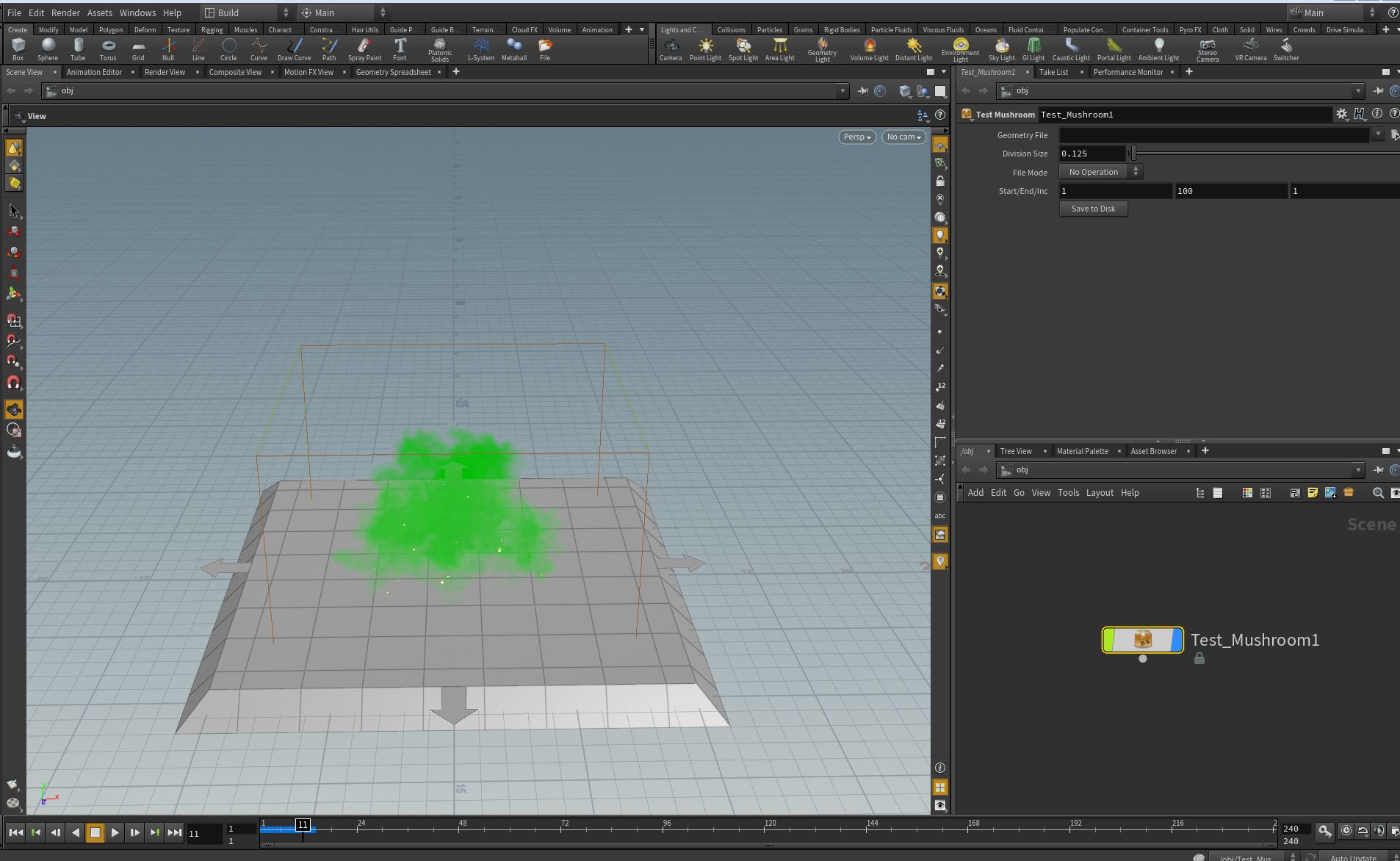

Attached isn't the main HDA I created from the set up, but a simple version as shown above where I have deleted the second Pyro sim, and the particles, and all the file nodes etc, just trying to see what could be causing the change in dynamics.
Also I have attached the set up before converting minus the particles and second Pyro sim.

Looking at the attached files, this does not seem to be a problem with Maya or Houdini Engine in particular, since the Test_Mushroom hda produces bad results in both Maya, and in Houdini. If I load the hip file and create a new hda from the pyro sim, the same problem happens in Houdini if I then do a File->new and create a new instance of the asset. Looking at the sim in more detail, there are warnings on a number of nodes (mostly the bypassed ones, but a few live ones too, might be worth checking for references outside the hda)
If there are other more complex hda's that work in Houdini but sim incorrectly in Maya then that could be a separate problem.

It managed to totally pass me by but there is a VOPSOP subnet which was the outside reference, I expanded and copied the contents outside of the subnet and it works now.
Reading up a bit VOPSOP is no longer used in H16 so tried first to rebuild with Point VOP but it doesnt work.
I'm a bit lost with that regard and need to study more, essentially from what I can tell the VOPSOP is taking the normals of the sphere and changing to velocity with random values. How would I do this with the Atribute VOP?
