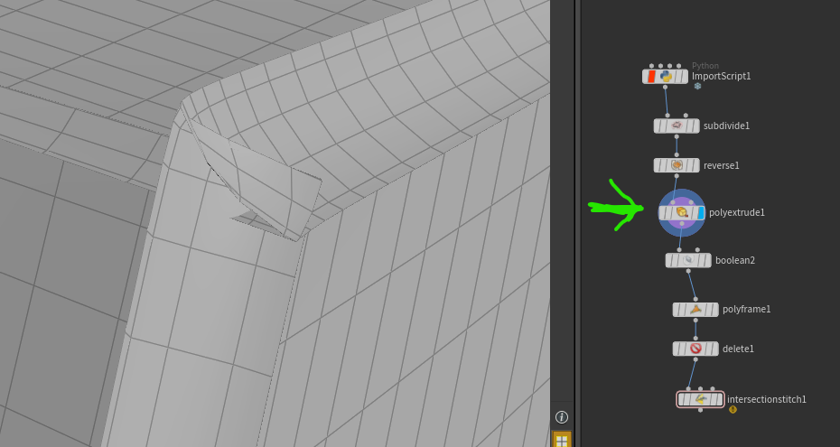

I thought about poly extrude but negative extrusion will give polygon intersections and mesh errors so I played with volumes is the answer I think.

I`ve tried also to do IsoOffset but it`s heavy computing way. I would prefer poly extrude but I have to cut away self intersections (on corners).
7 posts
I`ve found way to remove self intersections after poly extrude.
After making Boolean with one source I can see only intersections without base.
As second node I can see whole mesh with same intersections.
Question:
How to slice out intersections from whole mesh to have polyextruded base without intersected corners.
Any tips?

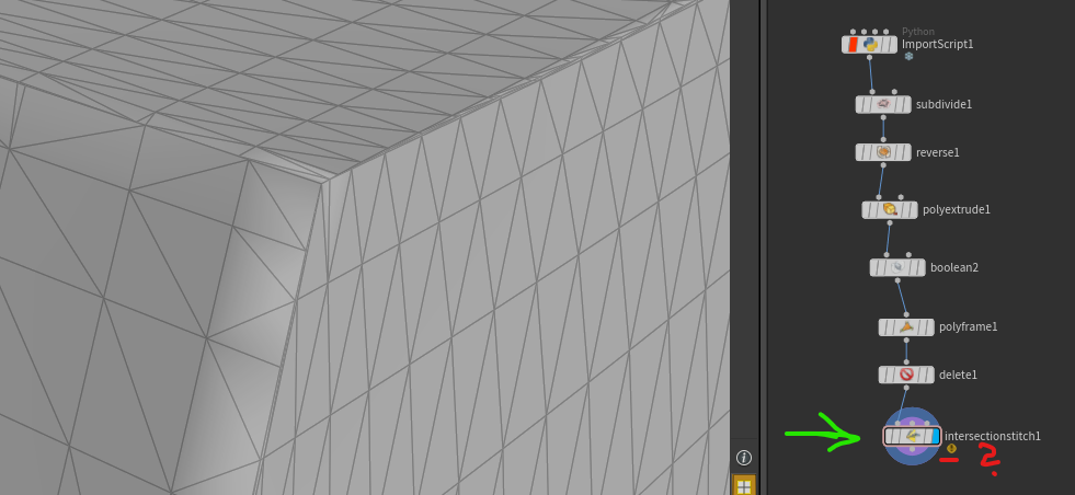

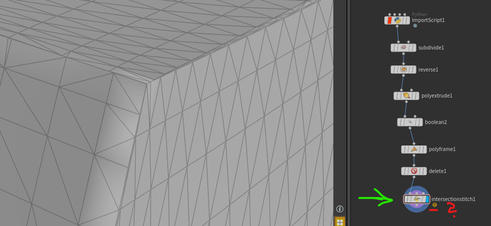

OK. I`ve handled self intersections after polyextrude in other way.
- boolean as surfaces to slice intersections
- polyframe to group areas to select it manually and delete unwanted strips
- intersectionstitch to stitch raw areas after deleting strips (to have one shell mesh)
It works well but maybe there is some better way for that?
Please tell me about intersectionstitch. Should I worry about that warning: “A triangle and curve mesh is required on the input for correct attribute output.” ?
