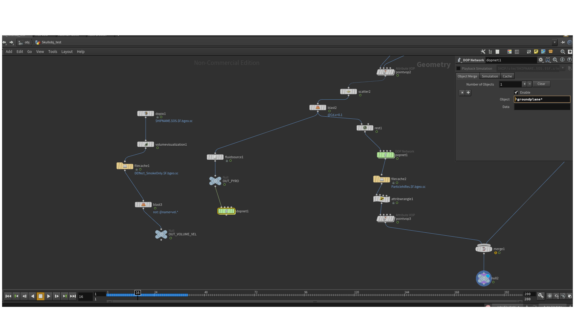

I have created a ground plane and I do not want to render it… When I turn it off, I still get a black plane in my scene.. Please help me with this issue…. I don't want to render out my scene with that black plane..
issues with render.jpg (328.3 KB)
2660 posts
Joined: June 2008
More than likely you are including the ground plane when you fetch the result from your AutoDopNetwork contained inside geo1. You can filter what you import using ^groundplane1 to exclude the ground plane from being fetched back into your SOP network. Also try turning off the Proxy display of the groundplane itself, inside the DOP network.

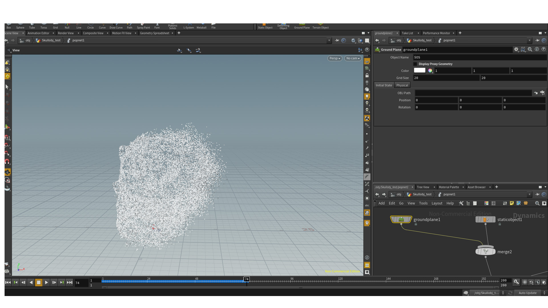

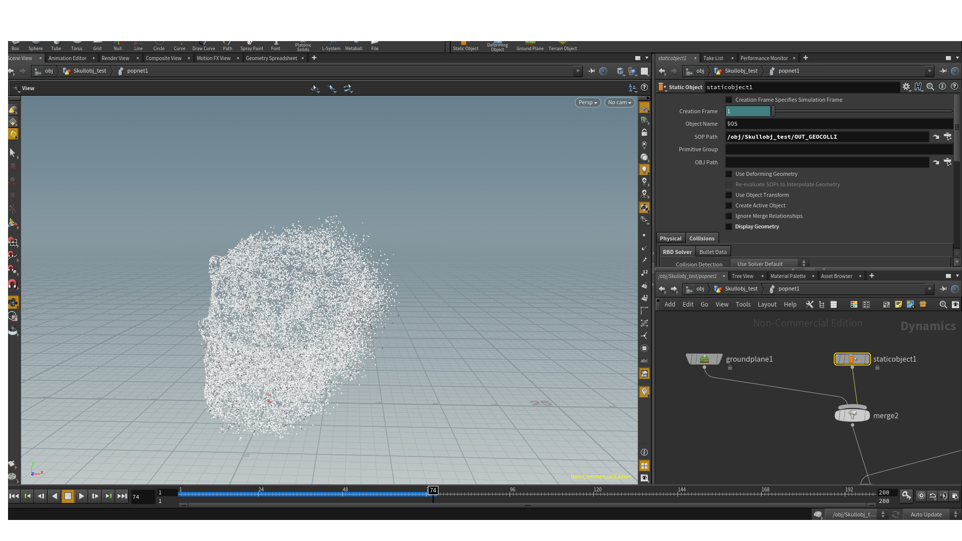

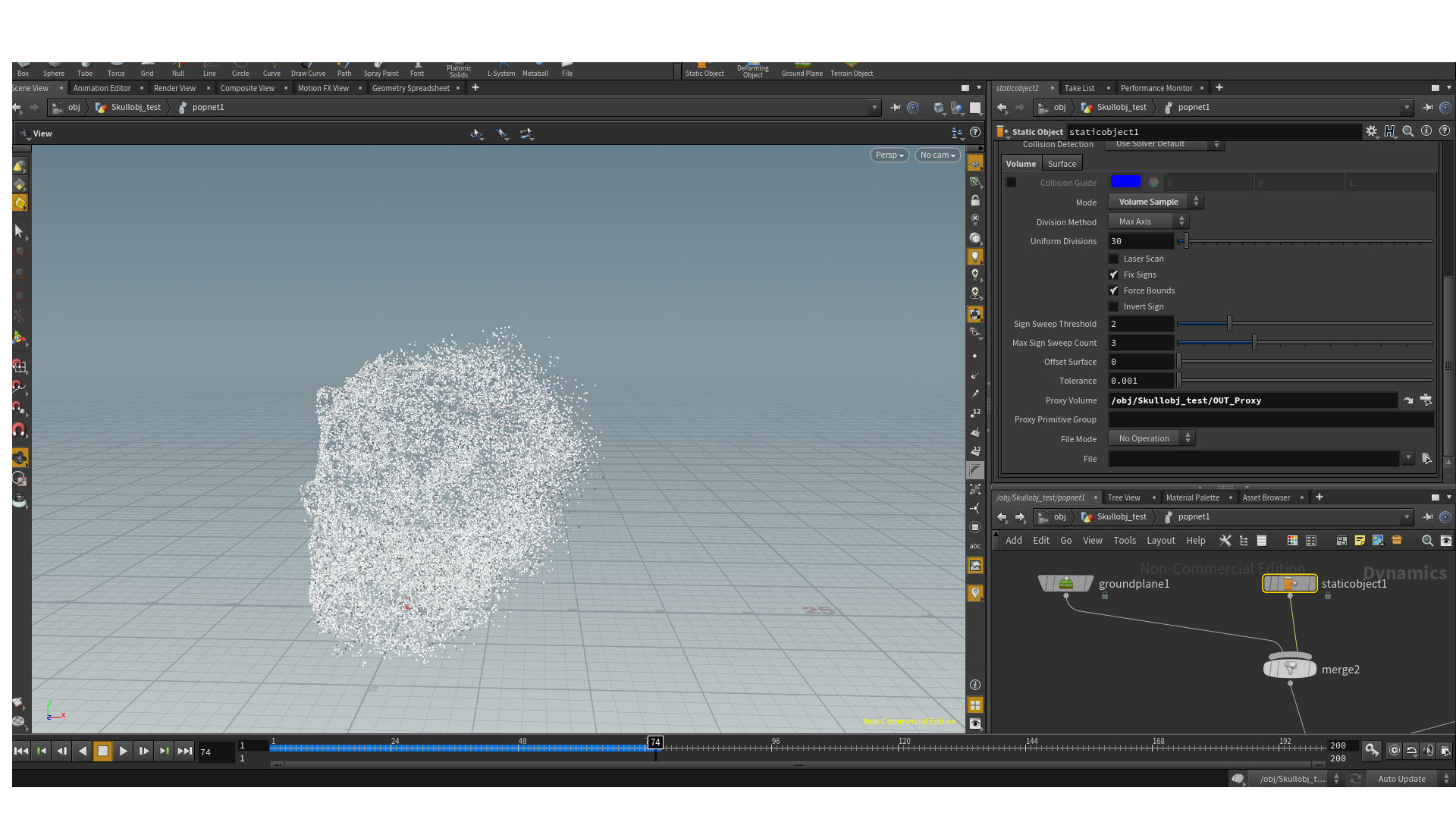

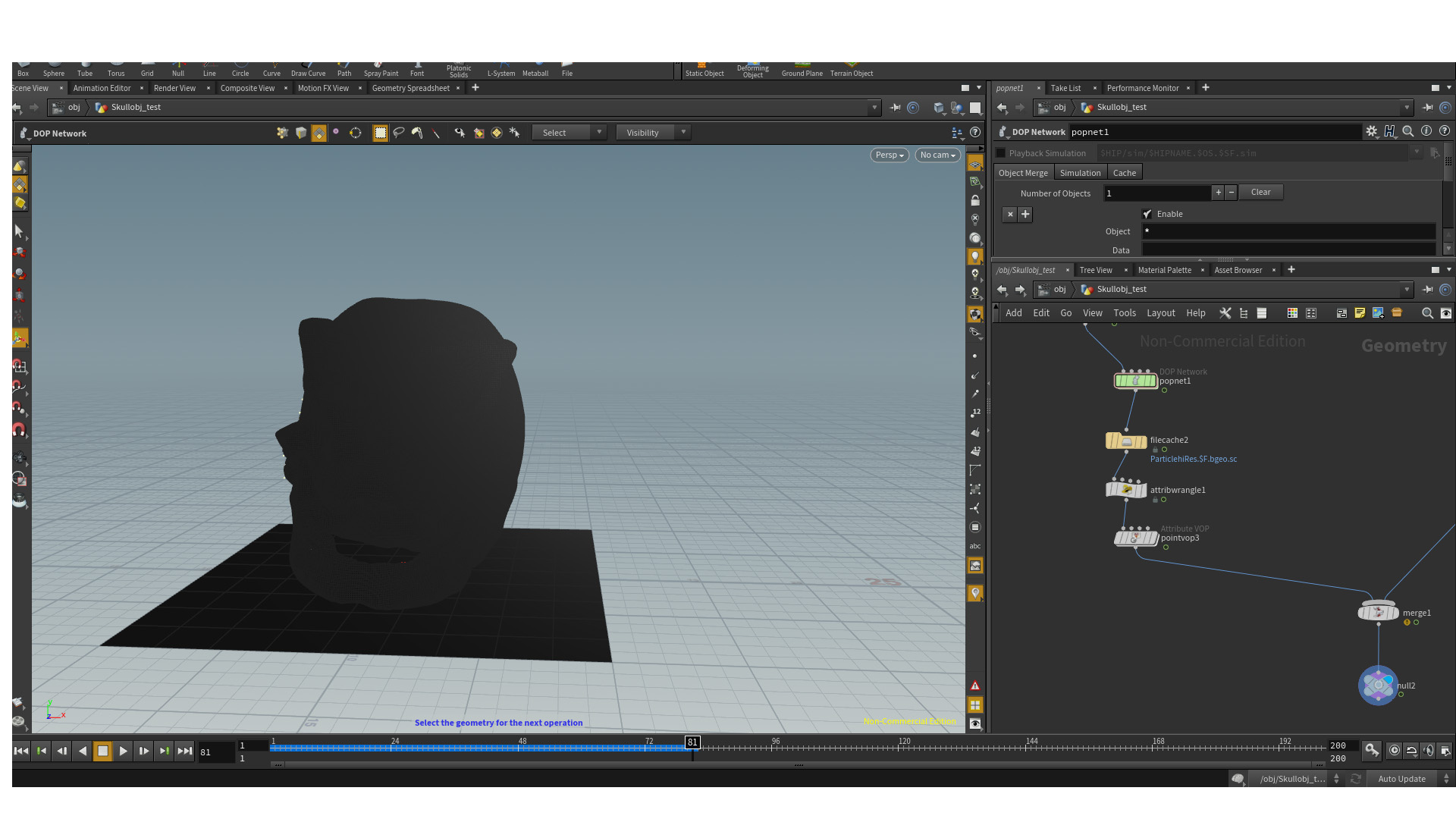

Hi Enivob!! Thank you for your reply.. I went back to check my geo 1 and also try the exclude … but it still carries both my VDB object and ground plane as a ghost black objects in the scene… I try to use the facet sop and check the post computer normal but it will just put the particle texture back to the plane and the skull obj.( instead of black)… Here are more screen shots….
Attachment Not Found
11 posts
Joined: Sept. 2009
And ….. Thank you AGAIN!!!!
I fix it by typing the exclude in the popnet instead of the dopnet!!
And it works!!!!
Many thanks!!!!
2660 posts
Joined: June 2008
Cool, glad you figured it out.
Using Houdini Indie 20.5
nVidia 3060RTX 12BG RAM.
Joined: Nov. 2018
Using this text in the DOPNET>Object line would have removed your ground plane as well: * ^groundplane1
