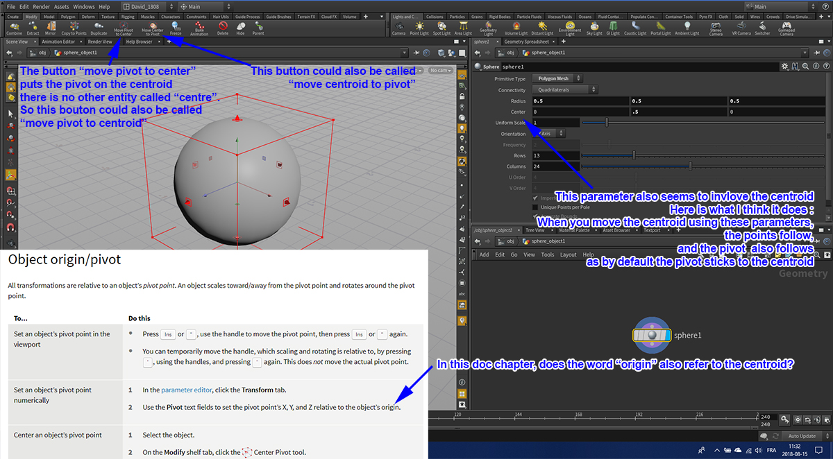

Ok after a bit of research (also with the help of my Hou trainer
) I am able to answer some of my questions.
First find enclosed a pic I made in which I bring some conclusions + 1 question.
- “The center is a point in space that defines the position of an object”
The center is the centroid, aka the center of the bounding box of the points. What confused me is that the centroid is also called “center” in the GUI and the docs, so I thought the center was a “third entity” in addition to the centroid and the pivot.
- “The pivot is for the user to transform the object. Its parent is the center. It can be offset from the center.”
The pivot kind of contrains the centroid/center. The centroid can be offset from the pivot using a transform node in geo level.
- “Is the pre transform used to alter the center's position , rotation and scale?”
The pre-transform is like an invisible parent Null inside each object, it is independent from the centroid/center and does not affect the later.
- “How can I visualize both the center and the pivot at the same time in the viewport ?”
I guess there is no visual cue for the centroid/center but I still think it would be useful, especially when using the buttons “move center to pivot” and “move pivot to center”, of which I will talk again later.
Greetings
