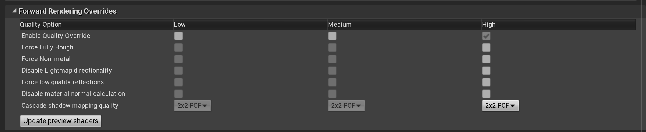

These are the iOS material settings that are currently unchanged in Unreal Engine 4.
