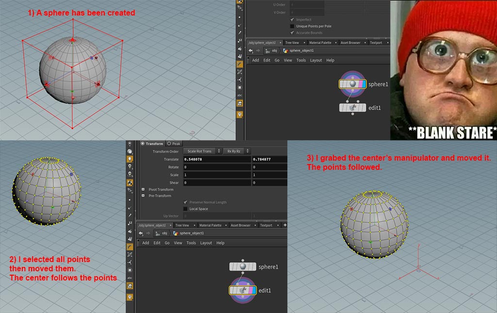

As for XSI’s “center mode”, I have not found the Houdini equivalent. In XSI you can move the center while the points stay in place, but in Houdini, if you move the points, the center follows, and if you move the center, the points follow. Check the attached picture I did.
