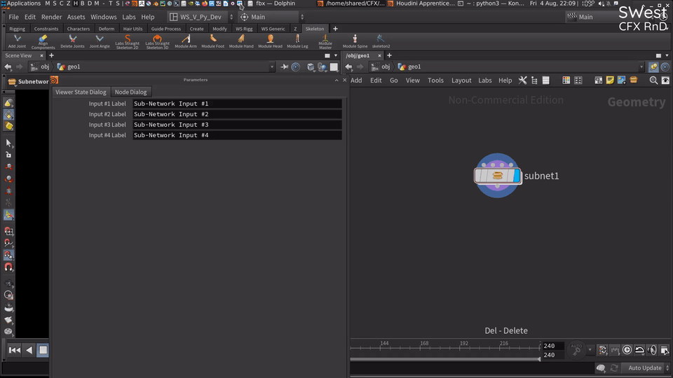

Sorry I do not understand exactly what you want to accomplish. Anyway, you can use the built in documentation. Basically like this.
Subnet
Add a null to the output of the subnet
However, if you know how the network should look it is easier to build it manually then export the nodes.
Subnet
