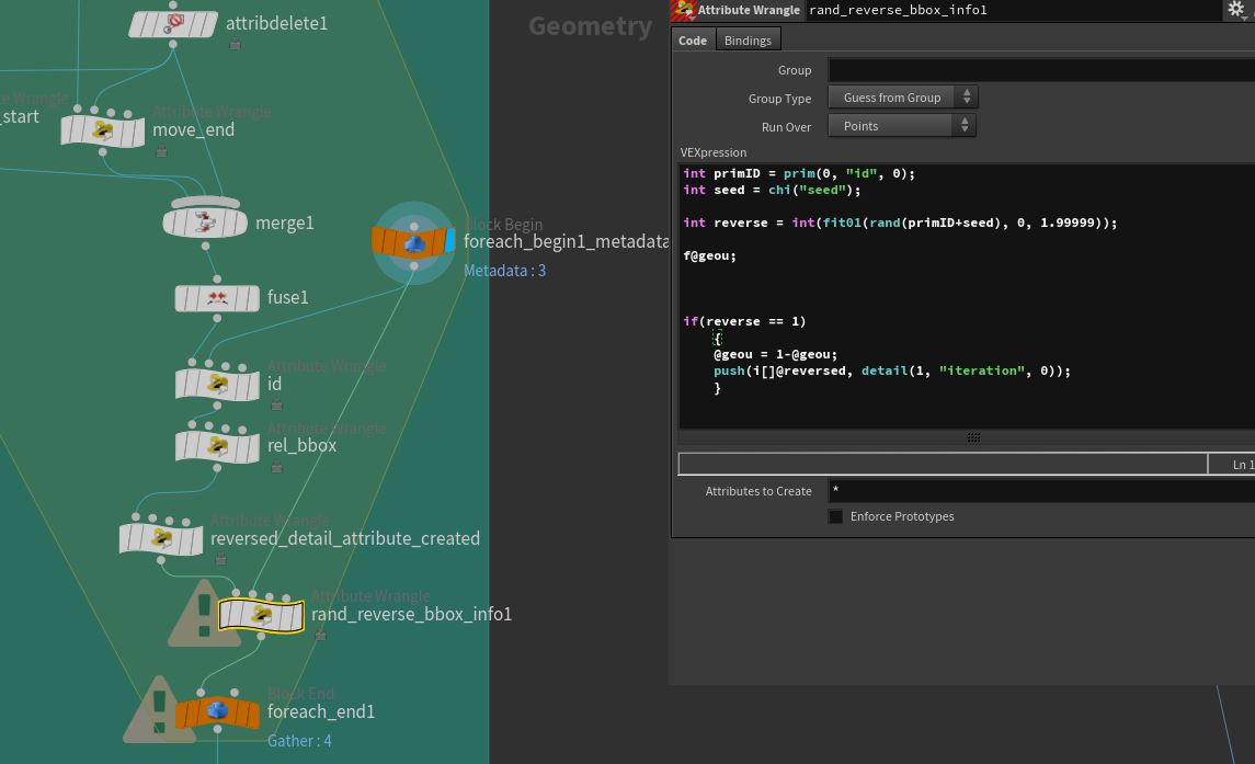

Hi!
In a for-each sop I made an empty array in a detail wrangle:
i[]@reversed;
…and in the next point wrangle, I'm trying to append the iteration value coming from the metadata in an IF statement. I get an error and I don't know what I'm doing wrong:
int primID = prim(0, "id", 0);
int seed = chi("seed");
int reverse = int(fit01(rand(primID+seed), 0, 1.99999));
f@geou;
if(reverse == 1)
    @geou = 1-@geou;
    push(i[]@reversed, detail(1, "iteration", 0));
2180 posts
Joined: Sept. 2015
You need to cast the detail function.
push(i[]@reversed, int(detail(1, "iteration", 0)));
1218 posts
AHHH!!!
I always get stuck on the smallest details (get it?!)
Thanks!
