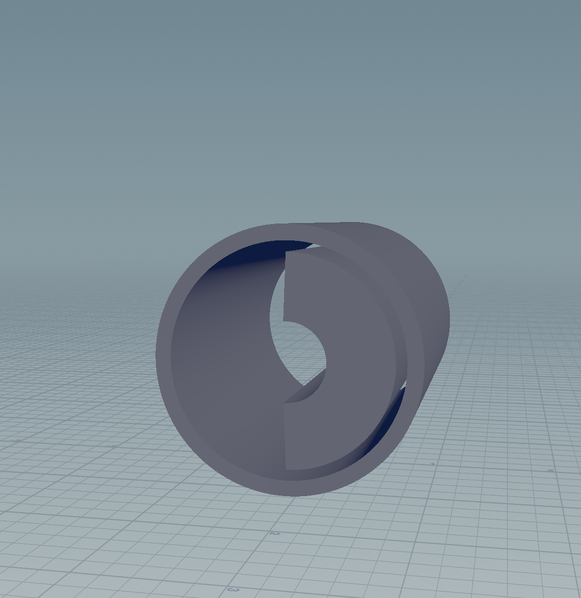

Working to isolate the various problems I'm asking about and to simplify things, one of the sub-problems I need to solve is creating a dynamics object that has a changing center of mass. As a very, very simple case, consider the attached image. If this were to fall straight down, intuitively we would expect it to roll to screen-right. But it doesn't…it simply just falls straight down, as if it were solid and uniform.
How can I encourage Houdini to recognize the mass of the internal structure? From there, I *should* be able to animate that internal half-tube (rotating it inside the outer shell), and have it “wobble” while sitting on a ground plane, yes?

this is a super late reply but have you looked into constraint networks?
http://www.tokeru.com/cgwiki/index.php?title=ConstraintNetworks [www.tokeru.com]
