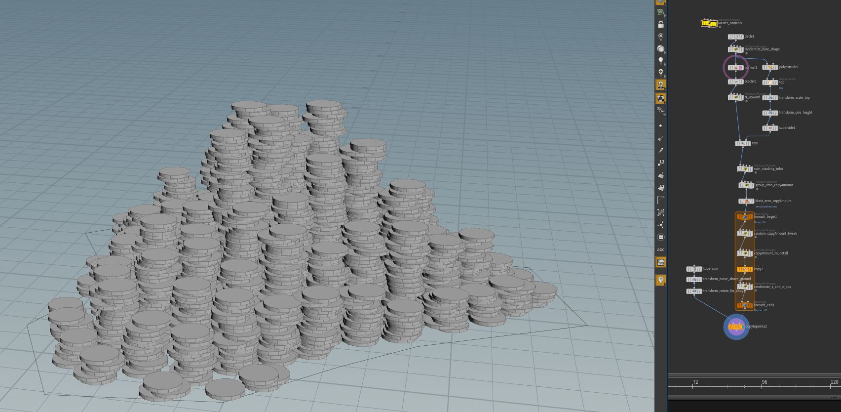

I ended up having lots of fun with it. Here's an example on how to make a coin pile.
If you select the “Master_controls” node at the top (yellow), you can tweak a bunch of settings.
-Olivier
coin_stacking_03.hip (135.6 KB)
