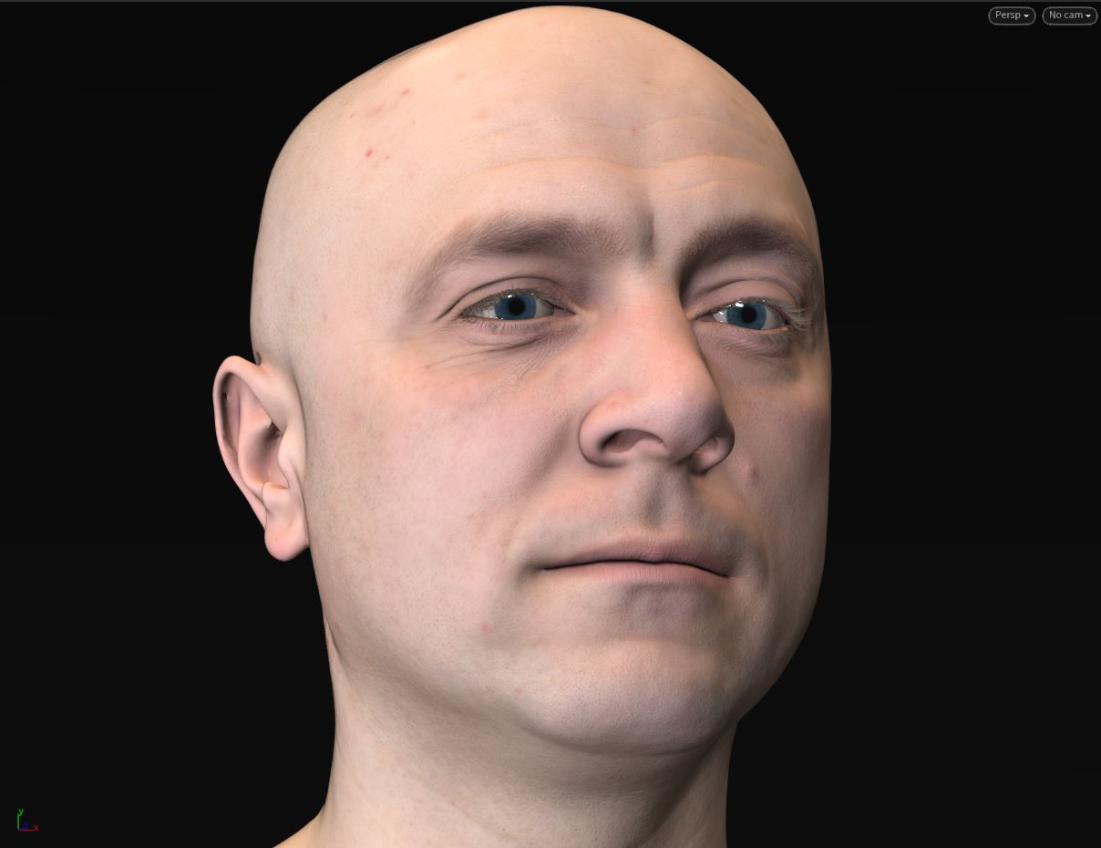

Viewport ogl transparency showing through objects? Is there a way to stop that?
   4905   4   0
109 posts
Joined: March 2017
The viewport would look great without that.
Is there a tag or something?
I tried the alpha tags but nothing seems to work.
Thx.
Edited by decksounds - Feb. 21, 2019 13:18:59
109 posts
Joined: March 2017
Here are some examples of the problem.
The speculars on the eyes are showing though the closed eyelids, back of the head, etc.
Edited by decksounds - Feb. 21, 2019 21:40:18
5340 posts
I think it's a bug in earlier Houdini versions - you can try turning the Transparency Quality down to “Low” (Effects tab of display options), that should work around it.
109 posts
Joined: March 2017
Yes, it does go away with set to low. It just looks a lot worse, like he has cataracts or something, lol.
Thanks!
Edited by decksounds - Feb. 24, 2019 00:02:41
109 posts
Joined: March 2017
twod
Just reporting that the problem persists in 17.506.
