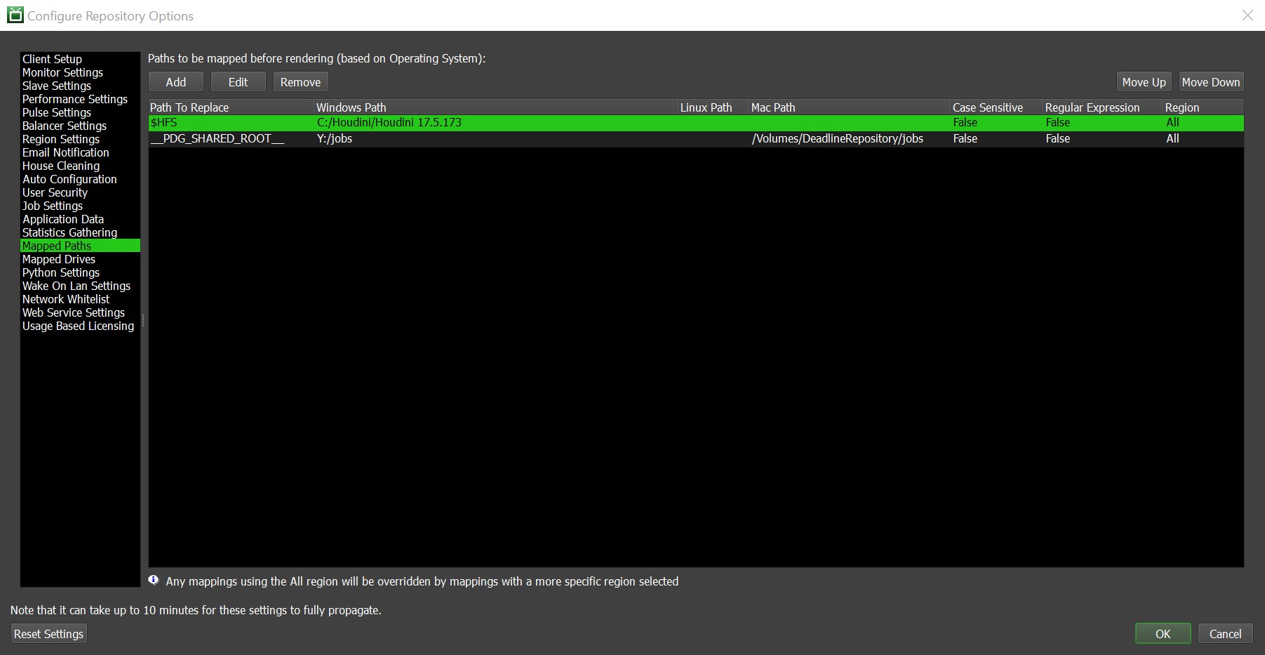

Did you set $HFS in your Mapped Paths in Deadline's Repository Options? See attached screenshot.

I see.
Setting path swapping to this:
still gives an error in DL:
Error: Executable "C:/Program Files/Side Effects Software/Houdini 17.5.173/bin/hython", does not exist. (System.Exception)

Looks like Deadline requires the .exe at the end of the executable. Our hython argument for the job lacks it, which is a bug we will fix next week. In the mean time, you can add another mapping to $HFS/bin/hython to force the .exe to be added in Deadline's Repository Settings. See attached screenshot.

Great! I figured out that i could just set the path to the hython executable in the Plugin Key values parm directly on the deadlinescheduler. And if i set Remote Shared Root to the same as Local Shared Root, i dont have to do any path remapping in DL. At our studio the two are always the same path but the root path can be different from project to project so it didnt make sense to have a global remapping of __PDG_SHARED_ROOT__ in DL.
