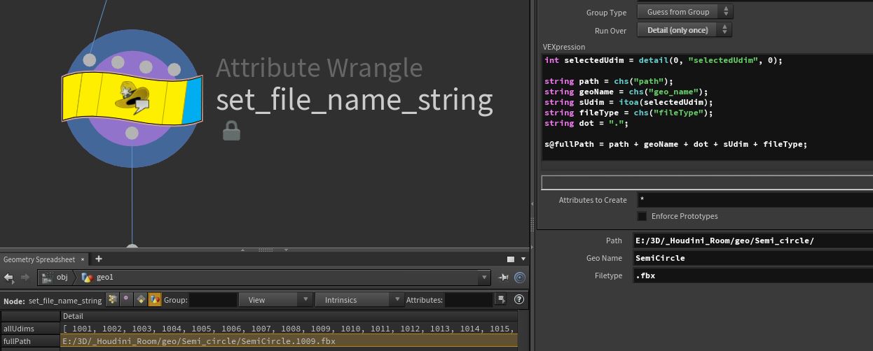

…I've made some progress.
I used a detail wrangle with this:
int selectedUdim = detail(0, "selectedUdim", 0);
string path = chs("path");
string geoName = chs("geo_name");
string sUdim = itoa(selectedUdim);
string fileType = chs("fileType");
string dot = ".";
s@fullPath = path + geoName + dot + sUdim + fileType;
That gives me the path I wanted: E3D/_Houdini_Room/geo/Semi_circle/SemiCircle.1009.fbx
The problem is when I try to use a detail function in the ROP_FBX sop. The function doesn't work. Probably because it thinks detail(0, “fullPath”, 0) is a string and not a function. How to solve this?
