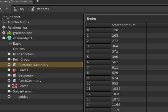

Trying to work with a sop solver in a dopnet to dynamically change the behavior of a vellum object.
Noticed that the primitive order of the constraint geometry gets rearranged by the “vellumsolver” for some reason.
So when I load the ConstraintGeometry into the sopsolver and merge the object with animated parameters and try to copy those values to the actual running constraints geometry I get a mismatch.
Now as a workaround I store the correct primitive id on each primitive on the incoming constraint geometry from the get-go and use that instead of “@primnum” but that seems excessively cumbersome. Am I doing something wrong?

prims get sorted during the graph coloring stage, so that the corresponding colors create continuous block that can be processed in parallel
you can submit an RFE to sort them back, in meantime your workaround is valid

@storedprimnum it is then
