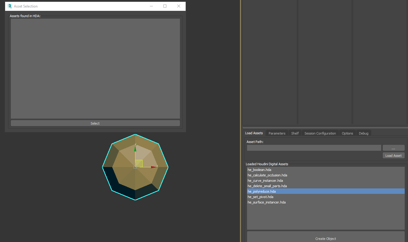

When I create an asset from Houdini Indie, I can load and use that asset in 3ds max as expected. Everything works fine.
However, on another computer, running Houdini Engine Indie, when I try to load the asset, I get this window:
That window is always empty, and I am unable to load or use the asset.

To narrow down the problem I have a couple questions:
Does the HDA have a .hda or a .hdalc extension?
That dialog appears when an HDA contains more than 1 asset. Is it correct that the HDA you're trying to use has multiple assets?

Just to double check: when you go to the Session Configuration tab, is there an active session running?
451 posts
Hello. Yes, there is an active session. I just tried using an in-built asset and I get the same result.
