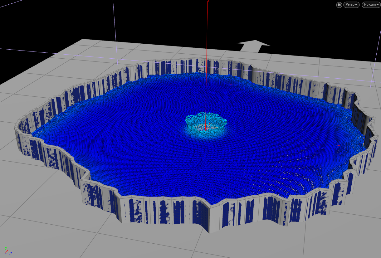

I have a project where I have to create a splash in a puddle.
So far I filled a puddle shape with water, simulated it to settle against a border using a static object. Then added a water droplet and drop it into the puddle. The results I am getting are OK, but could be better. I was wondering if anyone had any ideas or different approaches they can think of.
Thanks!
Screenshot from 2019-05-10 10-20-02.png (886.0 KB)

thanks for the response. Yes I do, I tried using that first, although I need the splash to happen in a actual puddle. Instead of a flat square.
At the moment I having trouble keeping the edge of the puddle still….
