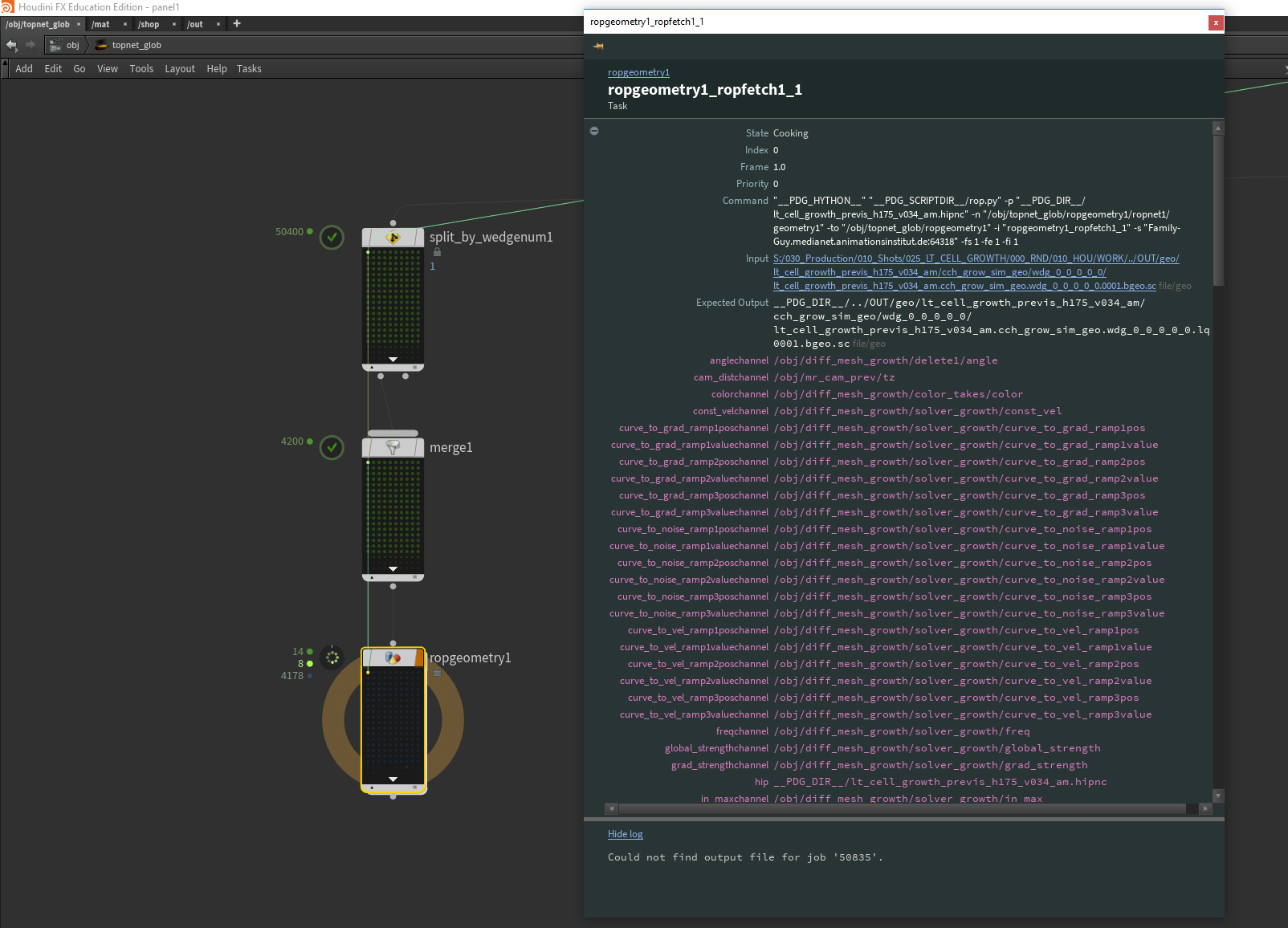

I have the following issue.
I have a Topnet that outputs wedge variations with a Ropfetch TOP.
Everything has been cooked and saved to disk.
Now I added another Ropgeometry TOP with some polyreducing procedures inside, and want to take the original result, process it and save it next to the original geo.
The “Expected Output” looks correct, the Python expression to rename the files seems to work as well (in theoery).
All files are on present on disk and the initial ropfetch TOP “loads” detects that they are already cooked, thus creating a green dot.
If I send this to my HQueue Farm I get the follwing Log and nothing happens.
“Could not find output file for job ‘xxxxx’”
I also tried using a Local Scheduler, there it sometimes worked, but not really reproducable, sometimes same error.
Any ideas to help me there?
Much appreciated
Thanks
Adrian
PS.
Another annyoing thing is that if I shift-v to abort it, Houdini freezes and crashes.
Houdini 17.5.229
Windows 10 64Bit

I found something out though, meanwhile.
I think it happens when I use a split TOP to extract some of the work items with an expression like “@wedgenum<2”.
Lets say I have wedge Top with 8 work items above.
That leaves me with all work items with a wedgenum below 2.
If I try to execute that, this gives me “Could not find output file for job ‘xxxxx’”

Havent tried that.
But it now works with Houdini 17.5.278 daily build. That was lucky.
I was so bold to dare and try to only upgrade to 17.5.278 on my PDG Host machine (which is also running HQueue Server).
The client machines on the farm still run 17.5.229 production build.
And somehow it works. I just hardcoded the “Universal HFS” on the Hqueue Scheduler to “C
Program Files/Side Effects Software/Houdini 17.5.229”.
Because it is such a pain to setup Hqueue on Windows on all farm machines, I would try a lot to avoid upgrading that every couple of days :-P
Thanks a lot though!
Program Files/Side Effects Software/Houdini 17.5.229”.Because it is such a pain to setup Hqueue on Windows on all farm machines, I would try a lot to avoid upgrading that every couple of days :-P
