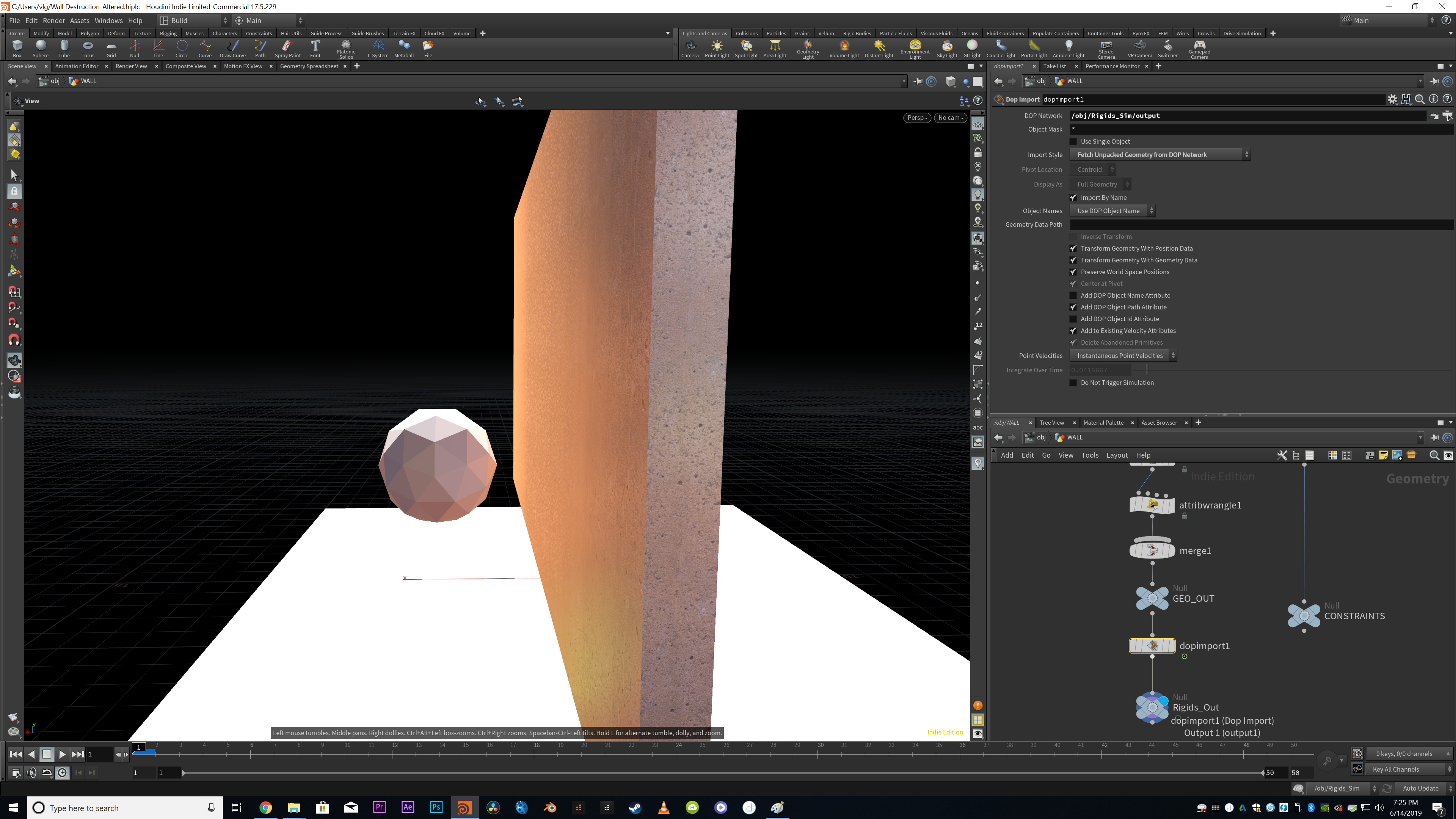

Okay I have a RBD Object inside a DOP Rigids sim. I was able to turn the RBD Object off from being viewed in the DOP Network itself, however when I import the DOP Network into a Geometry Node for some reason the RBD Object is showing up. Not sure where I can exclude this from being seen. Any ideas?
Let me know if you need any other information from me.

Hey there, All you have to do is delete the “*” and specify the “rbdpackedobject1” in the object mask field of your dop import node.
~Ilan
192 posts
Joined: Oct. 2018
Use the object mask in the dop import to fetch what you want. (Or use the ^ to exclude what you don't want…)

Thanks guys, sorry I didn't respond sooner. That was totally it thank you!
