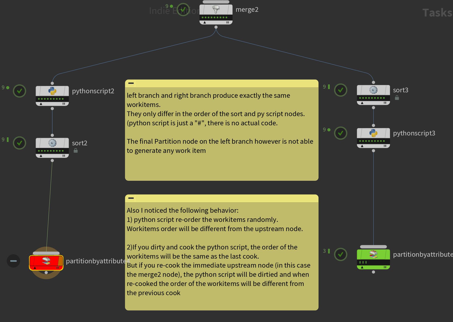

Regarding question 2: Why a blank python script prevents the python partitioner to generate partitions?
I have produced a case example where the python script is also able to break a partition by attribute node.
Also I noticed the following:
1) python script re-order the workitems randomly. Workitems order will be different from the upstream node.
2)If you dirty and cook the python script, the order of the workitems will be the same as the last cook. But if you re-cook the immediate upstream node (in this case the merge2 node), the python script will be dirtied and when re-cooked the order of the workitems will be different from the previous cook
Please, have a look.
Edited by Andr - July 5, 2019 15:01:14
- kenxu
- 544 posts
- Joined: Sept. 2012
Hi Andr,
So there are couple of issues here. The first problem is caused by the default setting on the Python Script node. The automatic setting here is putting the node in “dynamic” mode by default, where it should have been more consistent and put it to “static”. We'll make the change on the default, but for now you could either fix that by explicitly setting “static” on the python script node, or else turn on the “dynamic partitioning” setting on the partitioner node if you elect to keep the python script node “dynamic”.
The second issue is caused by the fact that when we have multiple workitems with the same attribute name, then the partitioner will elect to keep only 1 of the attributes as its own. You can get to choose which one through the sorting options in the advanced tab of partitioners.
In the longer run, we plan to have a specific node for this case. you'd wire it after the partitioner, and it exposes a bunch of merging settings sort of like the attribute promote sop. So you'd partition, then put down the “attribute promote” node which handles the merging of data from the items in each partition.
For now, your solution works because it orders the workitems in a way so that the one with the right attributes arrives first. Another way to solve this problem, for now, is to put a python processor after this partitioner and iterate through the upstream_items, which are partitions, and access their partitionItems and do whatever is needed with the data.
Edited by kenxu - July 5, 2019 16:14:28
