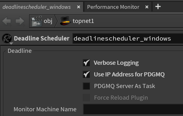

Hi Seelan,
While I'm debugging the above, there's something else that I would love to get your help with.
When running a TOPs dependency tree using “Submit Graph as Job” I'm running into 2 problems:
- custom Python modules don't get picked up
- custom environment variables are not being passed along
We're always launching our Houdini scenes in a specific show/sequence/shot environment.
The “PYTHONPATH” env variable specifies where to pick up custom Python modules and we're also passing some env variables such as “$SHOW”, “$SEQ”, “$SHOT” and so on.
If I run the same TOPs graph using “Dirty and cook selected mode”, it works just fine.
Here's a log in which I have a custom OTL in the /OUT/ context that imports some custom modules, on top of that I have a Python Script TOP printing some environment variables using "print os.environ for example.
Can I please get your feedback on this? Is there something that I'm doing wrong on my side?

You'll need to turn on Inherit Local Environment in the Task Environment section under Job Parms on the TOP Deadline scheduler. This will forward your Houdini envs to each work item.
You can also set specific environments using the Key-Value parm below that called Environment Key-Values. This sets individual envs for Deadline jobs.

Hi Seelan,
Thanks for the reply. After checking this parameter, I'm getting the same errors in the log.
Should I expect that environment variables such as PYTHONPATH or CLIENT, SHOW, SEQ, SHOT are being inherited now or do I still need to import those manually using the Key-Value parm below?

The environment vars defined in the hip file, and your OS env, will be copied into the Deadline job when you turn on that toggle. Make sure your save your hip file after making that change. When using Submit Graph as Job, you must save your hip file for the latest changes to be used in the cook since it uses the hip file on the farm machine.
If still an issue, please try with the next daily build (Houdini 17.5.386 or newer). I fixed a pathing issue when using a TOP Python Script node with Submit Graph as Job, though I don't see you getting that error.
As a way to debug your tasks, you can open up a generated task file in a text editor to see the env variables, task command, and arguments being provided. For example, from your previous log, here is one of your task files:

After installing 17.5.386 I'm now facing a new error that prevents my job from cooking at all after clicking on “Submit Graph As Job”, saying “Error: Executable ”python.exe“ is not rooted, and does not exist in the current directory or in the PATH.”
I verified the “task_0.txt” in the pdgtemp directory which is being created for the job and it contains a “PYTHONHOME” variable which points to “C:/houdini/17.5.386/python27”. I verified that this directory exists on the slave, which it does.
Error
Error: Executable “python.exe” is not rooted, and does not exist in the current directory or in the PATH. (System.Exception)

You'll need to add the python installed on your system in your OS environment, or provide the path explicitly on the TOP Deadline scheduler, under Paths > Python. Typically on Windows, the path is C:/Python27/python.exe
Also please see for setup instructions for the TOP Deadline scheduler: https://www.sidefx.com/docs/houdini/nodes/top/deadlinescheduler.html [www.sidefx.com]
Edited by seelan - Sept. 23, 2019 12:55:17
512 posts
Joined: July 2009
Hi Seelan,
Still struggling with the submission. I manually set the Python parameter on the Deadline Scheduler, see attached image.
While running 17.5.386 I'm trying to submit a single wedge to Deadline using “Submit Graph As Job”.
Interestingly, I see now 4 tasks in the Deadline Monitor, all of them failing. See the second image which I attached.
The log of the first Deadline job item is unique, the logs of items 2-4 are pretty much identical.
Here's the log for Deadline job item 1:

Looks like the result reporting mechanism is failing due to not being able to resolve STORMRIPPER01 (hostname) to an IP address. Do you have DNS enabled?
You can try enabling the Use IP Address for PDGMQ option on the TOP Deadline scheduler under the Deadline section. See screenshot.
