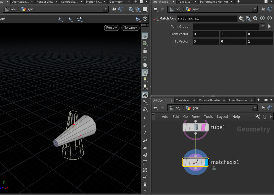

On a per object basis, if you mainly do modeling work then export at least, You can do your main work in Houdini's default Y orientation, then use a Matchaxis node downstream before exporting, for example. For Y to Z it would look like this:
