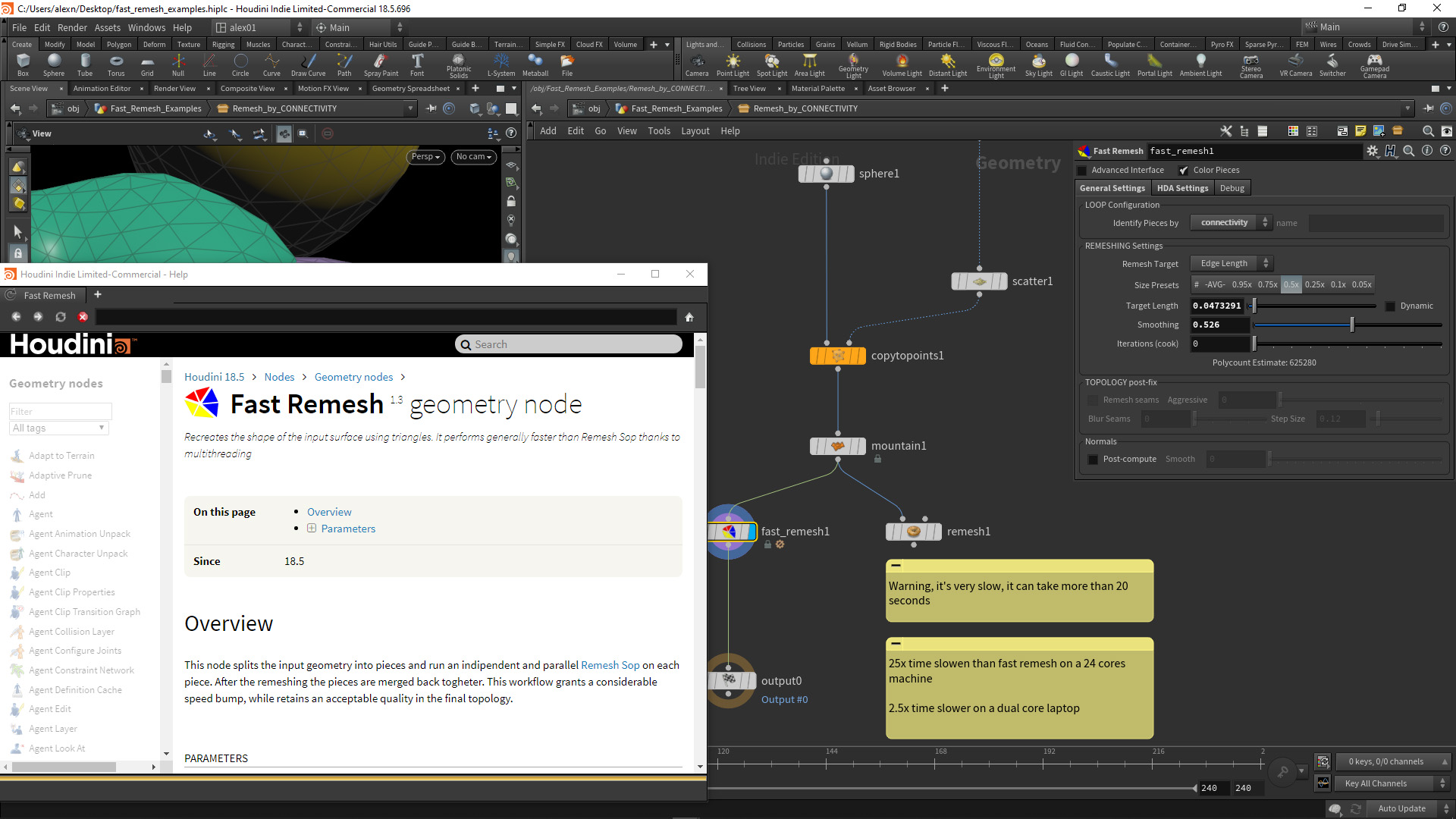

The icon won't show up in the Help Page, while it correctly displays on the node
the syntax suggested in the official guidelines won't work.
#icon: opdef:.?my_icon.svg
neither if just copy the path to my icon from the basic section of the operator type window.
#icon: opdef:/Sop/fast_remesh::1.3?my_icon.svg
Edited by Andr - Sept. 23, 2021 06:48:08

Hello Alex,
I created my icon with Inkspace too, uploaded it to the Extra Files section of my HDA, but can't manage to display it in the help page.
What is the syntax you use in the help section to show the icon?

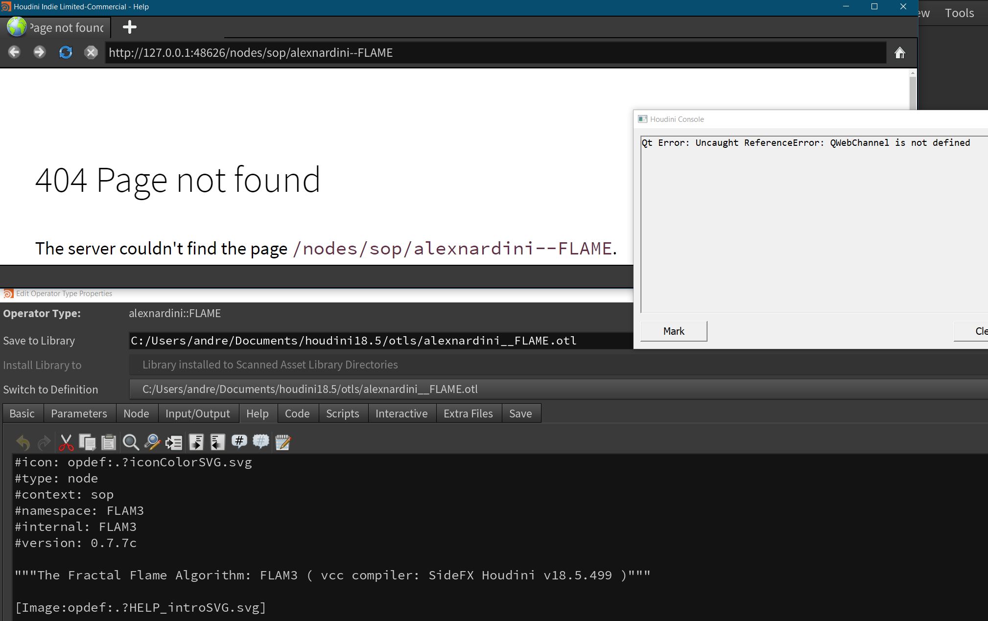

Hey Alex, good idea thanks.
However I can't even load the help page for your HDA.
Have a look at the screenshot...
mmhhhh
