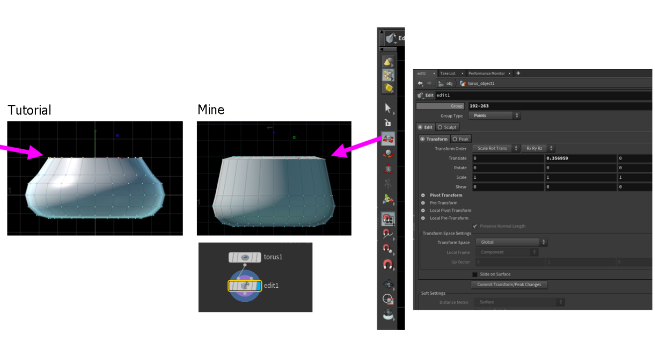

I am very new to Houdini,I am a Maya user.
I am watching a basic tutorial, it is in Houdini 16, I'm on Houdini 18.

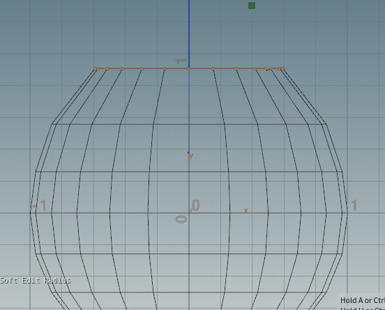

In the tutorial, the person grabs the top points on the torus SOP,turns on snap to grid, presses T and moves the points up. All the points snap to the grid.
However, I can't seem to get point to snap to grid; they are all remaining relative to one another.
Is there a setting I am missing?

in the tutorial he selects and snap only one row of points to the grid,
while you have selected two
though i'm interested too:
how to snap points to the grid without keeping distance (spacing) between them (so that both selected rows will snap to one grid's line) (?)

right now i may invent snapping without spacing only in this way:
snap to points + scale to seems zero by y (appears in red 0.00x) + then snap to grid
though during scaling something crazy is going on in the parameters and i manually set sy to 0
somewhy i think it makes points being exactly on one line
not sure why rotation and shear participate in it
(or doing sy=0 just in parameters without scaling in viewport)

Joined: Nov. 2018
I tried that method as well.
However, I'm not sure that I can guarantee that all the points are at the same Y value.
I wanted to see if I could do this using nodes rather than manually in the scene view.
I used a group, and a transform SOP(?)
What I did was selected the primitive(faces) and under the Base Group Attribute of the Group SOP, I manually typed in the numbers of the primitives I had selected. I used the Geometry Spread sheet to help with the numbers. Unfortunately, I don't know how to add selected faces to a group.
I then used the Transform SOP, set the scale.y = 0
I used snap to grid to move the points in the scene view.
I'm sure there is a better way and this is not how to do it.
Still learning.

You can do everything in one edit sop. Select all the points you want and snap them to a grid position. Then enter a 0 value in the scaling direction to align the points on a line. Works for me without any problems. There is no group or transform sop needed.
