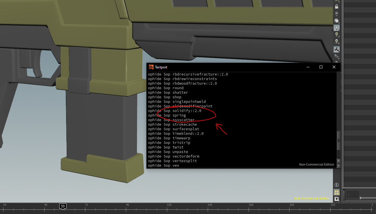

I wanted to do a standard solidfy procedure and I see in the documentation it says Solidify is no longer supported.
Is there an alternative to Solidify? Or is it temporarily not being supported due to them working on a new version - Solidify::2.0?
What is the deal with Solidify Sop? Is this now obsolete?

It looks like solidify is not the kind of solidify I thought it was.
I thought solidify was a traditional 3d modeling term but it looks like it is only called solidify in Blender.
In 3ds max it is known as shell, which is also described as ‘solidifying’ the object.
Is there a way to do something like this in Houdini?
