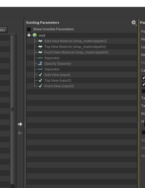

- I have a Multiparm Block controlling a for loop in the HDA to retrieve the parameters of the interface (iteration = multiparm #). All is working fine with most of the nodes I have. But a few of them are getting out of control (it seems to be the ones using VOPs actually, and/or ordered menus).
- To access the parameters from the interface, I use a Spare Input on the nodes (the metadata node of the for loop) so I can find which specific parameter I have to query.
You can see in this first screenshot the parameters I setup :
Once I Apply the change, and Edit the HDA again, some of the parameters are gone as you can see here :
And obviously, this is generating errors now that the parameters are not there anymore. The 2 nodes that are “losing” those parameters are AttributeNoise and Mountain, all the other ones are behaving as expected.

One other thing to mention, once the HDA is created (from the first screenshot), it works just fine, but it's when it's being edited afterwards that it loses its parameters …

1473 posts
Should be fixed in H18.0.365.
This was happening if a parameter was inside a multi-parm block an if it had a “parmvop” tag. This tag usually comes from Parameter VOPs, and most likely made their way to the Object HDA thru copy-paste. Anyway, these parameters should not disappear anymore.

Until I switch to the next version, is it ok to just remove the “parmvop” tag on those attributes ?
Cheers,
Julien
VFX Supervisor @ MPC London
1473 posts
Yes, you can remove the “parmvop” tags. They should not be there in the first place, since they make sense only for parameters of a node that has VOPs inside.
