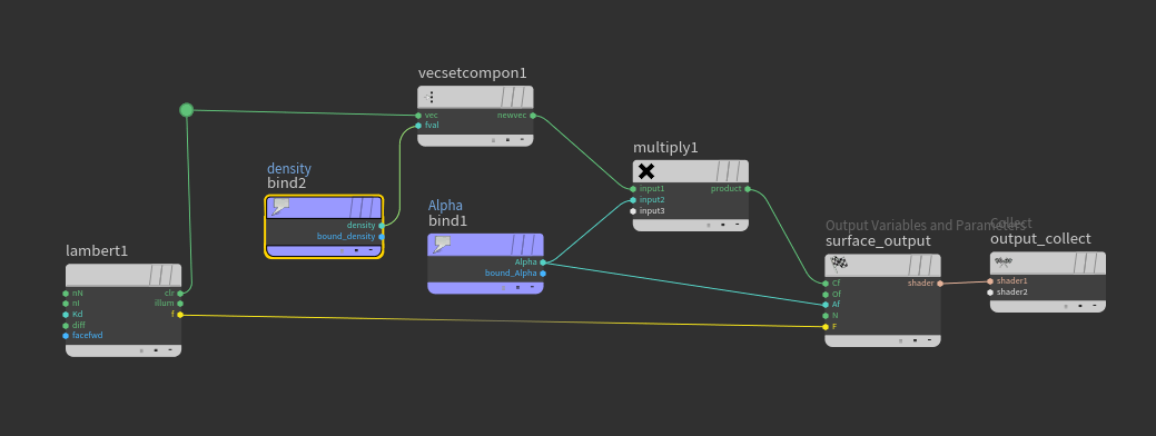

Here's one way; the lights I'm cheating by just colouring the top one red and the right one green, the alpha and density I get in a material; a bind vop looks for @Alpha and @density, which are assigned to blue and the alpha of the material.

no idea how you did that, but im playing inside the shader and got some basic RGB spliut channel working, still, no idea how to render two diferent light positions.
it was a big step, thank you.

Make two lights. One red, one green.
