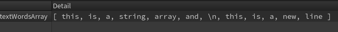

I'll post a hip file because I actually saw that a \n makes this little symbol when the string is made with a Attribute Create SOP.
With the method I had it didn't and existed just as characters.

I suppose that this could be done. The newline character needs to be escaped.
string strings = "this is a string array and \n this is a new line";
s[]@words = re_split(r'( +)|(\\n)', strings);
// Result: [ this, is, a, string, array, and, "", "", this, is, a, new, line ]

I did try some stuff with that r’()’ before, even tho I do not understand it fully.
But this code also doesn’t work in this hip file:
Also: I read that ‘regex’ is mostly the same, but that still different languages use different regex engines with small variations.
