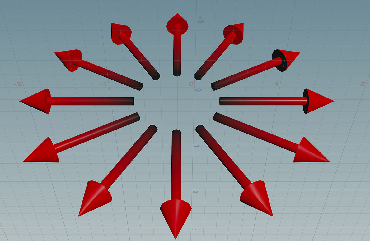

Hey guys! question; How do i get my normals on a circle to point outwards, with the goal of having anything I Copy to points, orient themselves in the same way.
What happens is this. I make a circle. Then give it normals. I then make a an additional curve.
But when I turn on “copy to Points” They shoot off like this. All the curves go into the wrong direction.
My ultimate goal is to have the normals point outwards like this.
https://i.imgur.com/hbjHvmP.png [i.imgur.com]
So that I can align my curves to that. Then randomize the length. So that I can use those curves to create a custom velocity for a splat simulation I'm working on .

You can create a circle of points with the normals facing away from the center of the circle but that will be a problem if you want a polygon face to the circle.
An easier way would be to have faces added which will fix the normal. See attachment (probably there is an easier way with VEX). The way I would approach this would be not to use copy to points at all but use a copy transform node with the object offset from (0,0,0) and have rotation in the copy transform set to something other than 0.

If your circle is at the origin, attach a wrangle after it with this:
@N = @P;
Make sure your line is pointing down Z when you copy it to the points.

Leaving out a copy transform (since it looks like you just want the force direction for your “splat”), All methods outlined will give the same result for a circle. However, if you make your splat a curve, you will need to decide if you want the force direction the tangent to the curve or from a origin (kemijo's method). I assume you are considering copying these points with a copy transform node and then an attribute transfer? See difference:

I'm doing it like this in a point wrangle :
vector a = set(0,0,0);
@N = normalize(a + @P);
504 posts
If your curve is in a plane, you can use the normal of the plane and the tangent of each curve point.
For example if your curve is in the XZ plane the normal (or lets say up vector) is (0,1,0).
If you apply the cross product on the tangent and the up vector, you should get the desired result.
