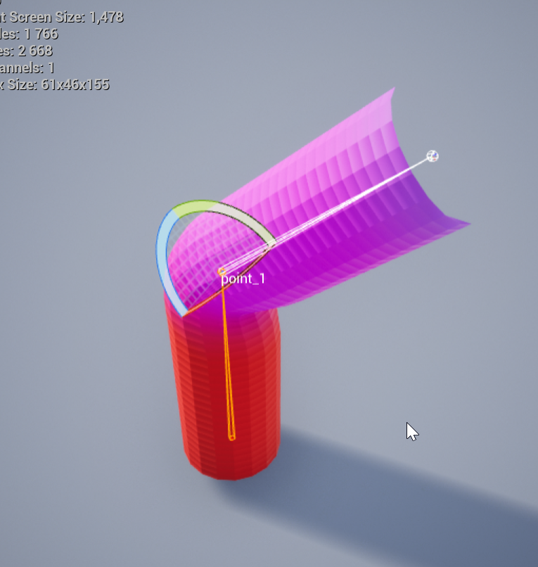

Hi, I'm facing issues while trying to export a mesh with skeleton and bone-weighted deformation.
The problem I get is that the Skeletal mesh doesn't import correctly in UE -- I get issues with normals, mesh flickers with black color, and on more complex geometry the skin weights are totally messed up.
My steps:
1. Turn a kinefx rig to an agent (agentfromrig, then agentlayer with the named skinned shape coming from bonecapturebiharmonic)
2. Import it to LOPs via Create SOP
3. Configure primitive agentdefinition to disable it and make not visible.
4. Import USD to Unreal
What is the proper way to export such assets?
USD characters from nvidia omniverse samples are working just fine in UE, so I'm pretty sure the problem is on the export side.
Any help is appreciated!
