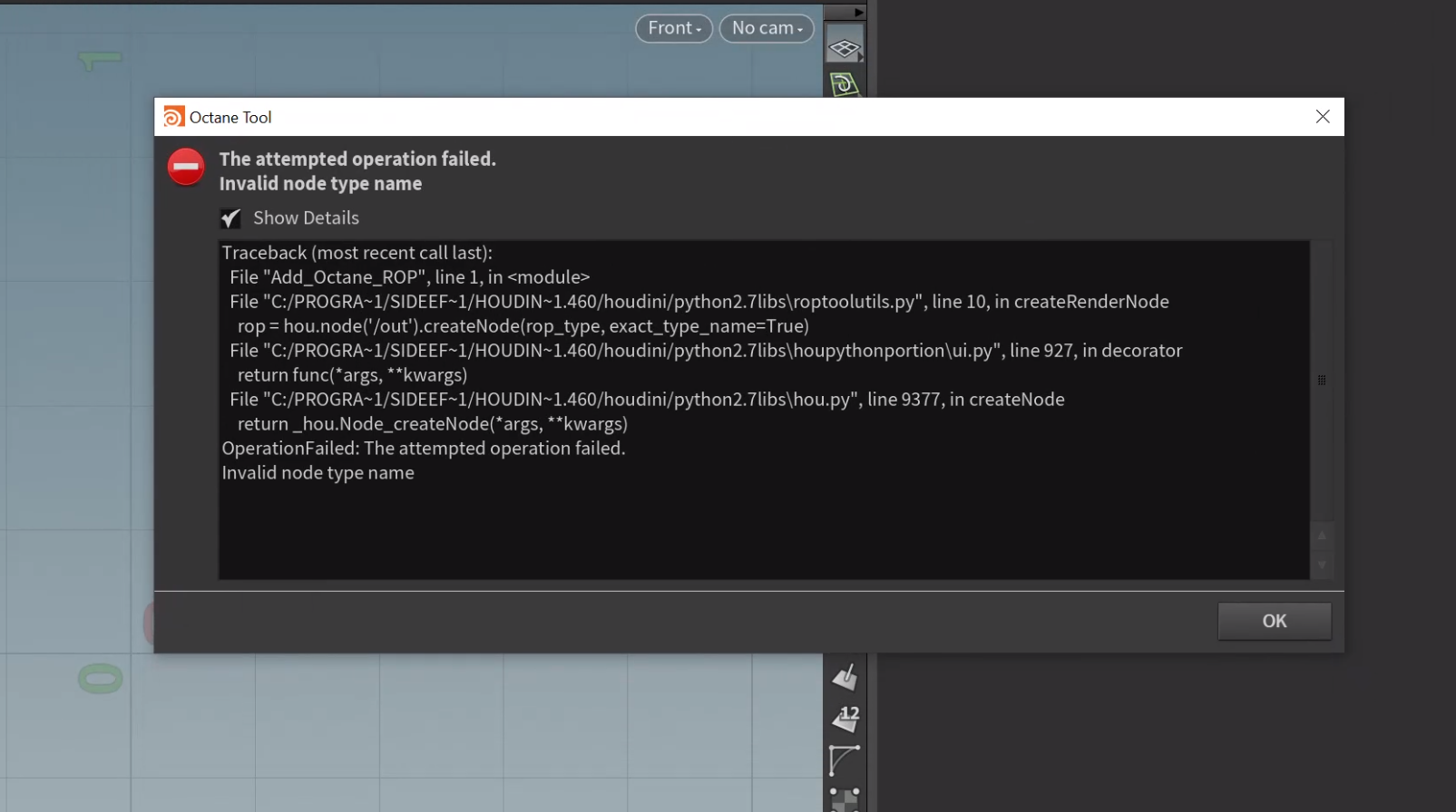

I'm kind of at a loss here. I have the .env file pointing to the correct version of Octane, but I'm still getting the “intended for a different version” error message (attached). I still get the menus inside of houdini, but then I get another error (attached) when i click on any shelf button.

I also have the same issue. I'm trying to run the demo version.
First of all I tried the packages and wrote the json file which mr.dyts said above here
but it didn't recognize
so I wrote the json file like this referencing the axiom's json file which is already recognized and runs well
"env" :[
{"OCTANE_ROOT":"C:\HoudiniSetting\Houdini18.5\packages\Octane_2020.1.5.3_Houdini_18.5.351_demo_Win64"},
{"HOUDINI_PATH":"$OCTANE_ROOT"},
{"PATH":"$OCTANE_ROOT/bin"}
it is recognized but once I try to put geo node at first, it crashes.
it says "17272: fatal error : Segmentation fault"
What should I do ?
I'm new to these kind of things so any help would be appreciated..
Thanks in advance !
(April 11, 2021)
The post I'm quoting was deleted for some reason (thanks google cache).
I had the same exact problem. You absolutely have to use the version of Octane that supports the Houdini version that you're using. I was using Houdini 18.5.561 but my Octane was "Octane_2020.2.3.1_Houdini_18.5.351" - so if a new Houdini version drops you gotta just be patient. It worked only a few times until it broke when I installed SideFX labs. Now it all works fine even with SideFX Labs because the versions match.
