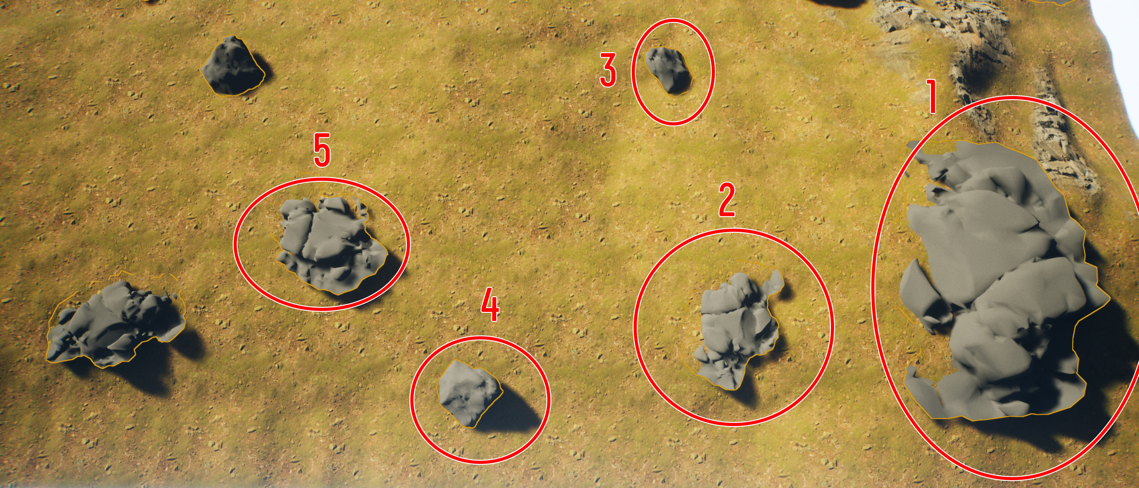

I got a terrain where I need to spawn some assets (rocks).
When I spawn the exact same asset in Houdini onto the scattered points (via copy to points) they have a different size/rotation
than the ones that are instanced in UE4. I'm using pscale, normal and up attributes to set everything up.
I attached 2 screenshots to show my point - am i doing something wrong, or is this a bug?
