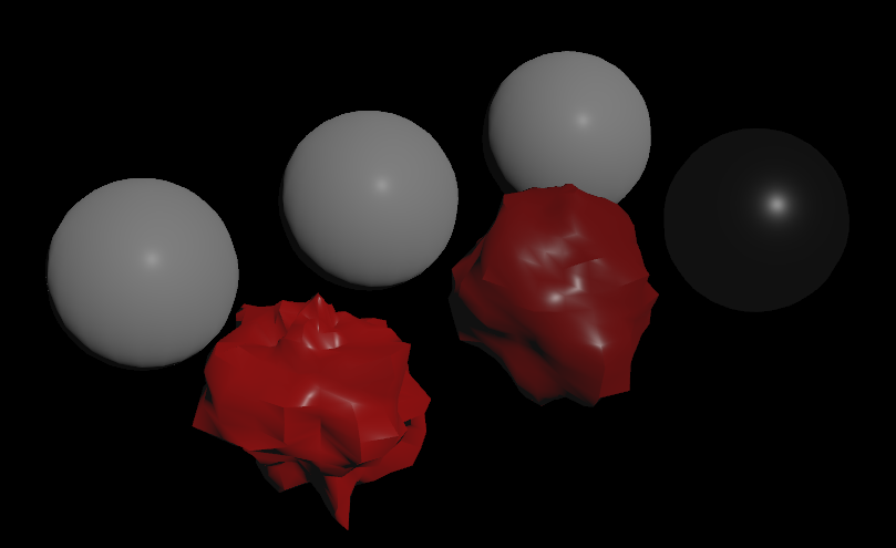

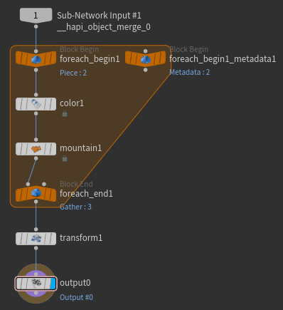

Here is one way you can achieve that. A name attribute is added, so we can use the “For Each Named Primitive” node to loop through each object. In the attached file, I have also created a meta import node so that I can extract the loop index and use that to drive the color and intensity of the mountain height parm.
