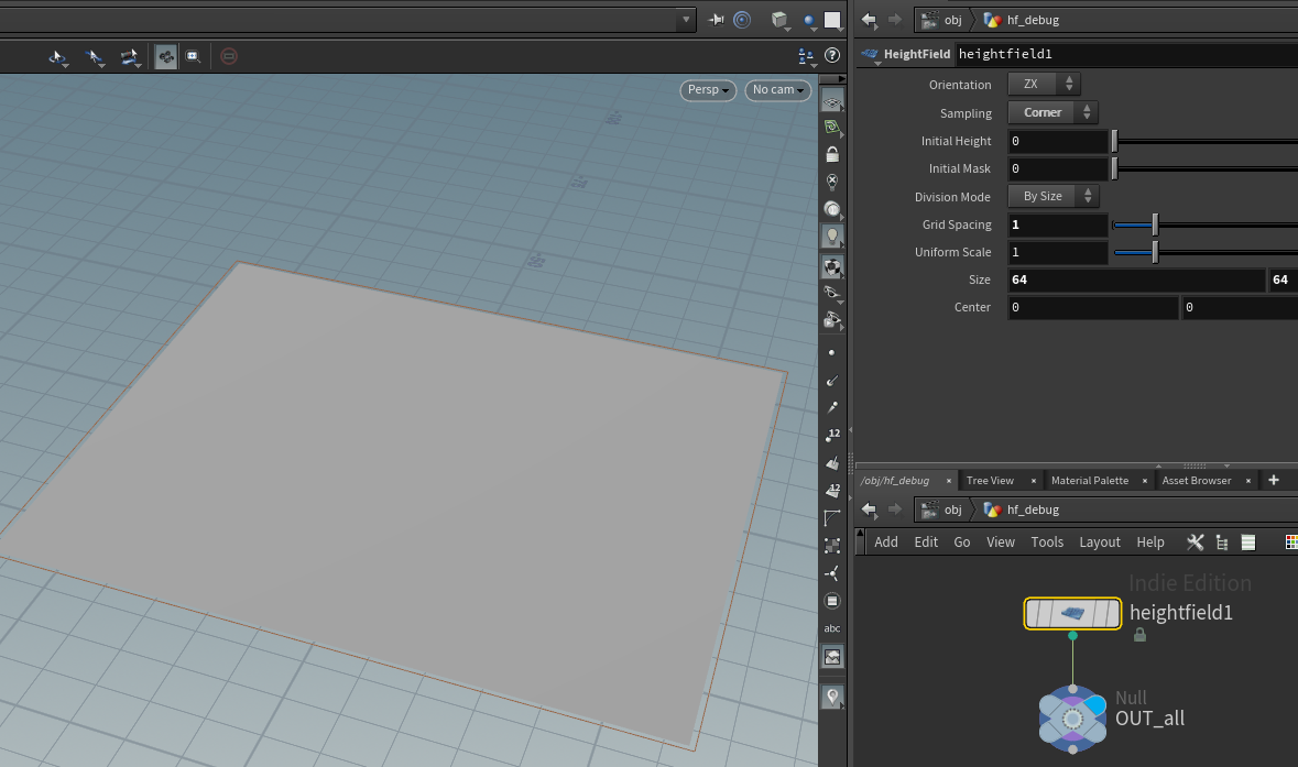

I'm having trouble importing the simplest heightfield into Unity. Is anyone else experiencing this issue? It was working over a month ago since I've worked with heightfields but now nothing. No error in the Unity console neither.
- The HDA is a Heightfield > null.
- Heightfield is set up according to https://www.sidefx.com/docs/unity/_terrain.html. [www.sidefx.com] I've tried variations of the sizes and nothing works. See screenshot for the settings of the attached hda file.
- I've tried setting a material (in another iteration) to no success.
- Debug > Open Scene in Houdini shows the heightfield fine. However if I unlock the node for editing and save I get a Houdini Error which crashes the debug Houdini app instance.

Screen Shot 2020-12-23 at 10.27.43 PM.png (385.5 KB)

The issue was that my material wasn't using the correct shader. Be sure the assigned material in Unity uses the Nature/Terrain/Standard shader. Otherwise your terrain will be invisible.
