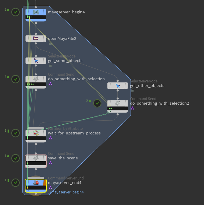

To do that you don't actually need a partitioner as the Command Server End is a partitioner itself and does it for you.
I tweaked your example file a bit to illustrate it, hope it helps.

Hey,
Maybe my initial question was to confused, i was trying to achieve a process that would (simplified):
1. get some sets of objects (characters, props, lights)
2. process each group (maybe put it in a render layer)
3. when all the groups are processed, save the scene as a new version
So without a partitioner before the command-server-end, my 'save scene' would get executed multiple times (per each upstream work item)
This is why *i think the prior-to-save partioner is required: see attached screenshot
