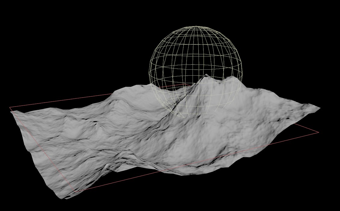

I tried cutout by object and mask by object, but its not what I am after.
I want to subtract sphere from HF. How do we do it in Terrain universe?
Thanks!

#include <volume.vfl>
vector pos;
vector uvw;
intersect(1,@P,{0,1000,0},pos,uvw);
@height = -pos.y;

This worked for me
vector pos;
vector uvw;
int hit;
hit = intersect(1,@P,{0,1000,0},pos,uvw);
if (hit != -1) {
    if (@height > pos.y) {
        @height = pos.y;
hit = intersect(1,@P,{0,-1000,0},pos,uvw);
if (hit != -1) {
        @height = pos.y;

There is a node for that: Height field project (set to Minimum method with "Hit farthest" disabled).
Thanks, that's exactly what I needed. I was trying that, I just didn't know I need to disable the "Hit Farthest" for it to work the way I want it.
I was looking around above and I was thinking "do I really need to run all that code to be able to do something so simple?"

haha I had exactly the same feeling when I wrote this code. It just felt wrong.
Well yeah, it seems to be using the intersect()-function under the hood. That's why the terms used may be a bit uncommon.
