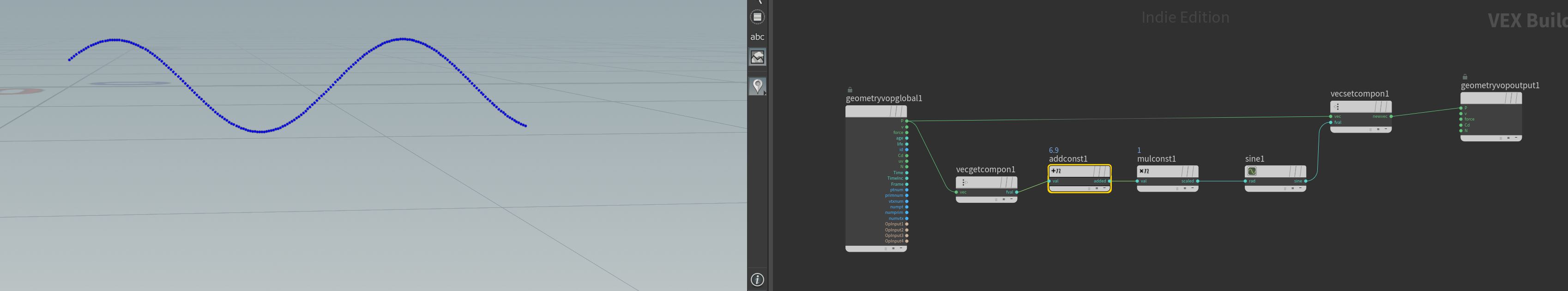

Hi I am trying to learn houdini starting with VOPS sometimes math goes over my head.
I am making a Sine Wave out of a line of points I am adding a Multiply constant node before the Sine that basically multiplies the amount of waves...when I add an ADD constant node it doesn't add more waves instead it offsets the sine waves no matter how big the number.. Is the sine node able to distinguish between add and multiply and treat them differently? I was expecting the add node to add waves just less of them than the multiply but it offsets the sine?

Yes my file is similar to your file if you use an add constant after multiply you will get the behaviour where
the add constant offsets the sine while the multiply constant multiplies the waves...

If you wanna add more waves, i.e. modify frequency you can modify the yellow node. Am I missing something?

HI animatrix I just want to understand why.. the add node offsets the sine wave while the multiply adds more waves, would't the add also add more waves just less than the multiply?

Oh I see. The add operation is basically offsetting the waves because adding doesn't scale the point positions it just moves them like 1 becomes 1+x, 2 becomes 2+x, 10 10+x, but their relationship to each other is still the same, compared to multiplication which indeed scales the point positions and therefor the frequency of the waves changes as a whole.
