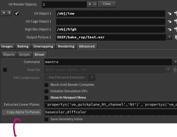

Hello,
I used to have no trouble baking textures, but no matter what I do I always have seams. I am not sure which version this started happening. If I use the lab bake texture node (which seems to be using an older version of the texture bake rop) it works perfectly fine. Look at my viewport render. the left side is using the texture bake rop and the right side is using the labs texture bake (as I said, I think its using an earlier version of the bake rop node). I practically mirrored bake texture rop settings to the labs bake texture, but its still not working. Also notice how the extracted image from the texture bake rop has an alpha channel for some reason so you dont get the filler diffuse color Any thoughts?
Edited by evanrudefx - June 9, 2021 03:01:58
bake_test.zip (12.0 MB)
Thanks,
Evan
266 posts
Joined: Feb. 2016
found the problem in an older forum post. In the bake rop driver settings, the the alpha channel is being copied to the extracted image planes. You can just leave that empty and your texture will work.
