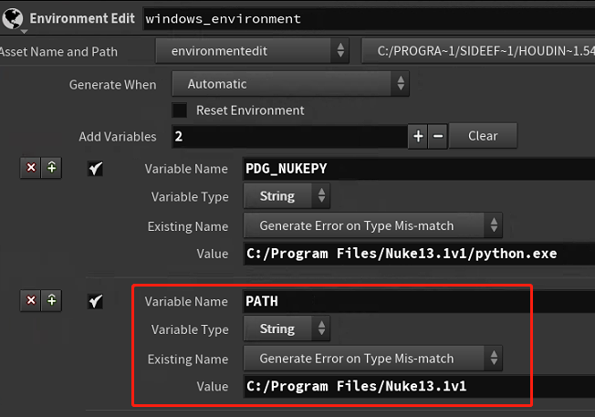

I have exactly same issue. After some try and error, i fixed it by adding nuke directory to path environment variable.
