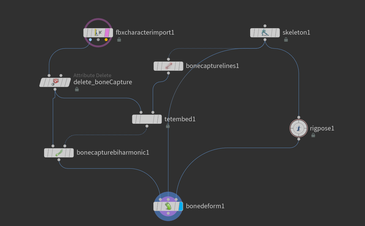

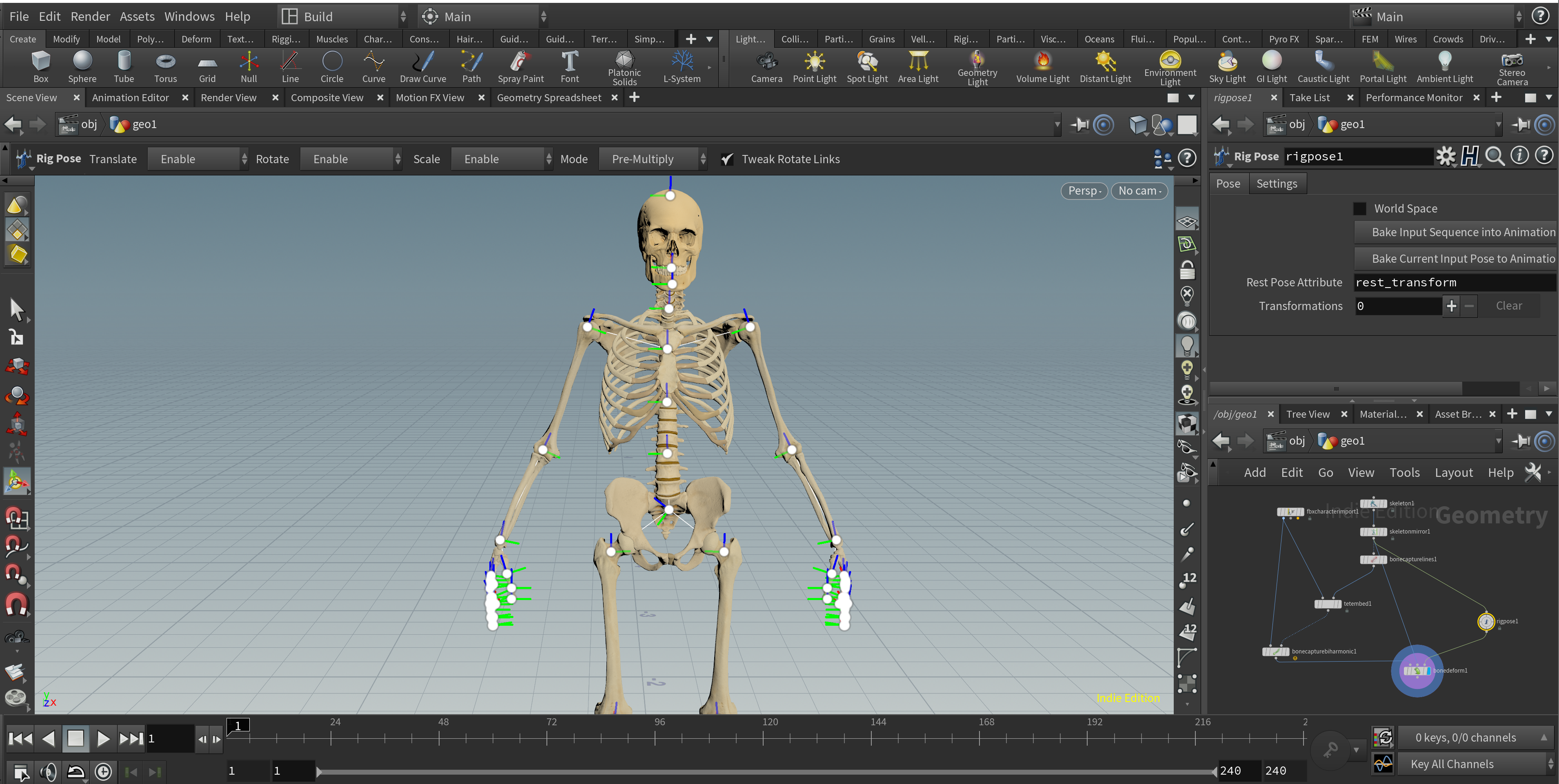

I created a rig from scratch in KineFx, but for some reason the rig will not Capture the Geometry. I'm a new houdini user, so any advise would be much appreciated. Thanks.

Have you tried first removing the capture attributes from the captured mesh? The error says that the weights are already present, so it could be useful to remove the old before applying any new.

I removed captured attributes from the mesh which removed the warning. But that still hasn't changed anything. The rig will not capture the geometry.

When removing the boneCapture attribute, make sure that you remove the attribute from both the input to the Bone Capture Biharmonic and the Tet Embed - normally this would mean using the same node as input to both.
