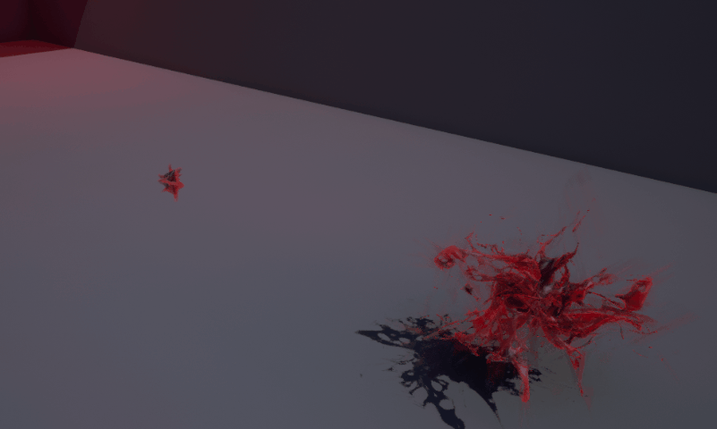

Hello, I've managed to make it work as a Mesh particle but for some reason the animation is not as smooth as on the static mesh. Is it maybe the Interframe interpolation?
The one on the left is the Mesh particle plugged in a Niagara System with the legacy features.
The one on the right is the static mesh with the default VAT material.
UE5
Houdini 18.5.696
Hey, interframe interpolation is not possible with Dynamic Remeshing (Fluid) mode. The right one looks like it has motion blur on. Did you set up motion blur for your simulate? There is a slide on the guide about motion blur and how fluid mode's motion blur must be configured differently from the other 3 modes.
Please see if that fixes it, if not, feel free to send us a test file to debug.
Cheers.
