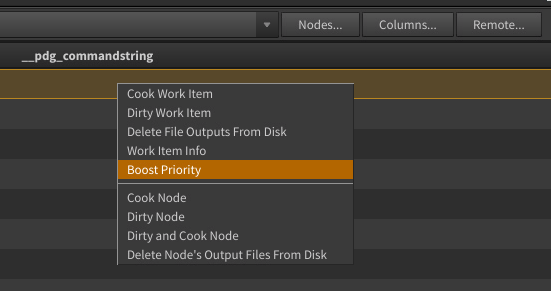

Can you please explain why Remote Task Graph Table doesn't have an option to Boost Priority for workitem (while with a local graph it exists)?
Is there any way to send a custom command to boost workitem priority in the remote graph?
Screen Shot 2021-09-06 at 9.18.53 PM.png (48.1 KB)
Screen Shot 2021-09-06 at 9.26.02 PM.png (48.1 KB)

Reported as RFE (ID# 116220)

Solved in Houdini 19
