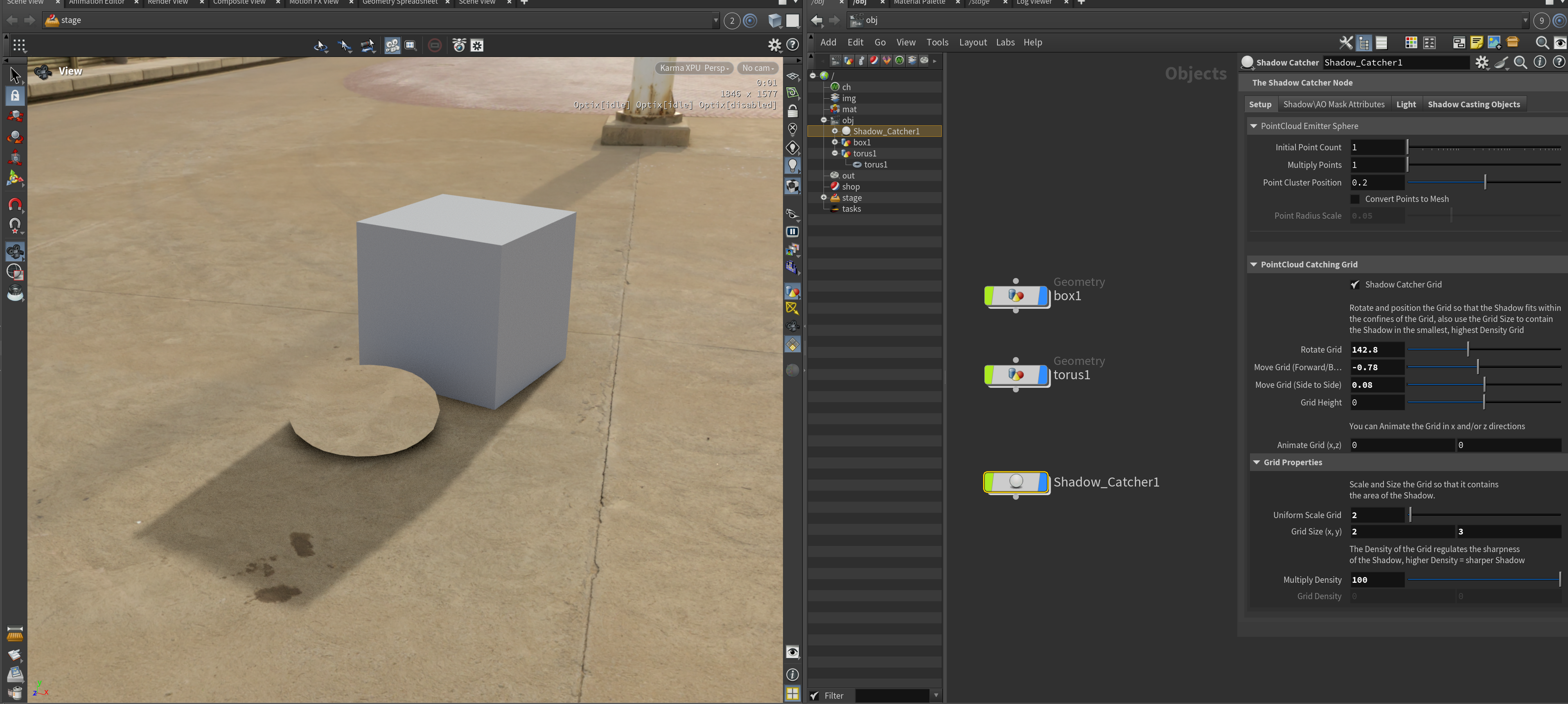

Does your shader handle matte properly??
Currently there is problem with shadowcatcher in H21,I;ve submitted bug a while ago:
In this case, grid is shadowcatcher and torus is matte. But instead having full matte torus still show shadows on it.
Does your shader handle situation like this properly?

Hi Mirko Jankovic, My Shadow Catcher has no issues related to the Shadow Catcher which comes with Houdini 21, My Shadow Catcher is in the Object level and is rendered with all the objects in the scene so the scene reacts to the shadows as they are really there, no compositing required, it's all in the beauty pass, my Shadow Catcher is a hda and is a single node, all the environment mapping, catcher grid and material are included, just select your hdri, select the objects you want to cast shadows from, import the ShadowCatcher node and your Objects into the Stage and Render with XPU, very easy, also you can store Recipes of the ShadowCatcher node with all your settings and HDRI to recreate any time, I have parameter settings to adjust the Shadow/AO, Light, Environment, Grid etc to suit any HDR image environment, I've been working on this for a couple of years on and off, but now I'm pleased with the results, no need for my Arnold Renderer any more.

Seems to work fine...

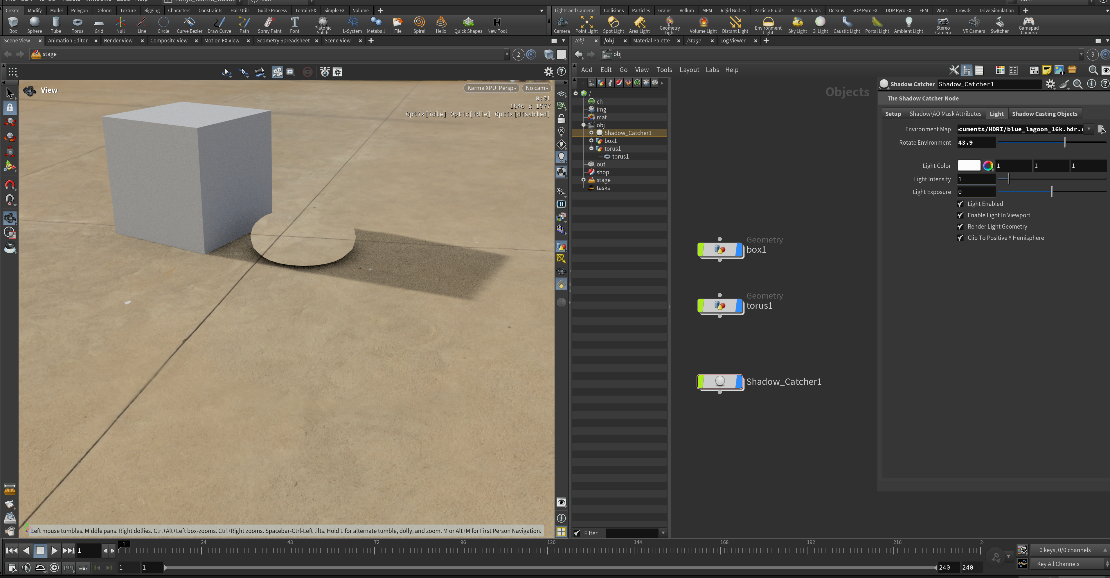

Same scene but with the parameters of the AO/Shadow tweaked

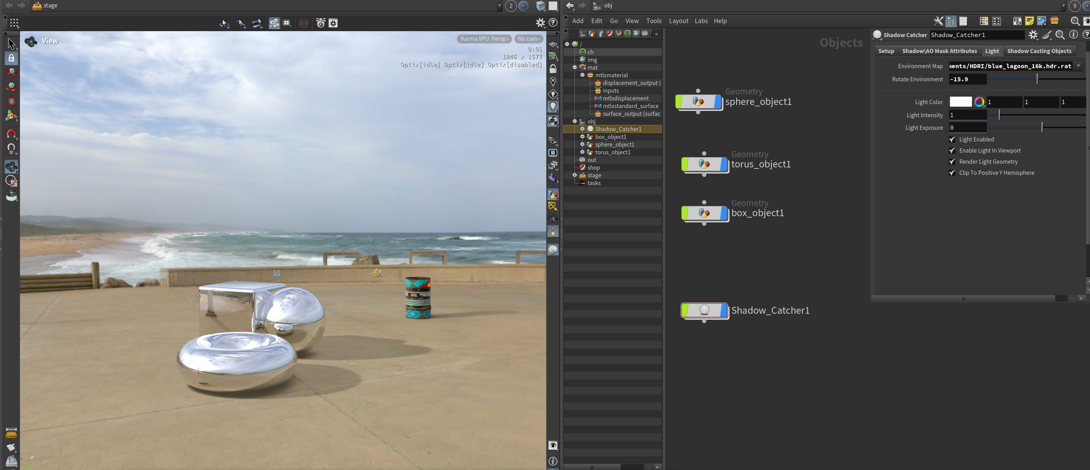

The Matte torus shows up in reflections, is this normal?

That actually looks perfect!
Ok @SideFX... buy this and implement!

It's very easy to match the shadows in the HDRI

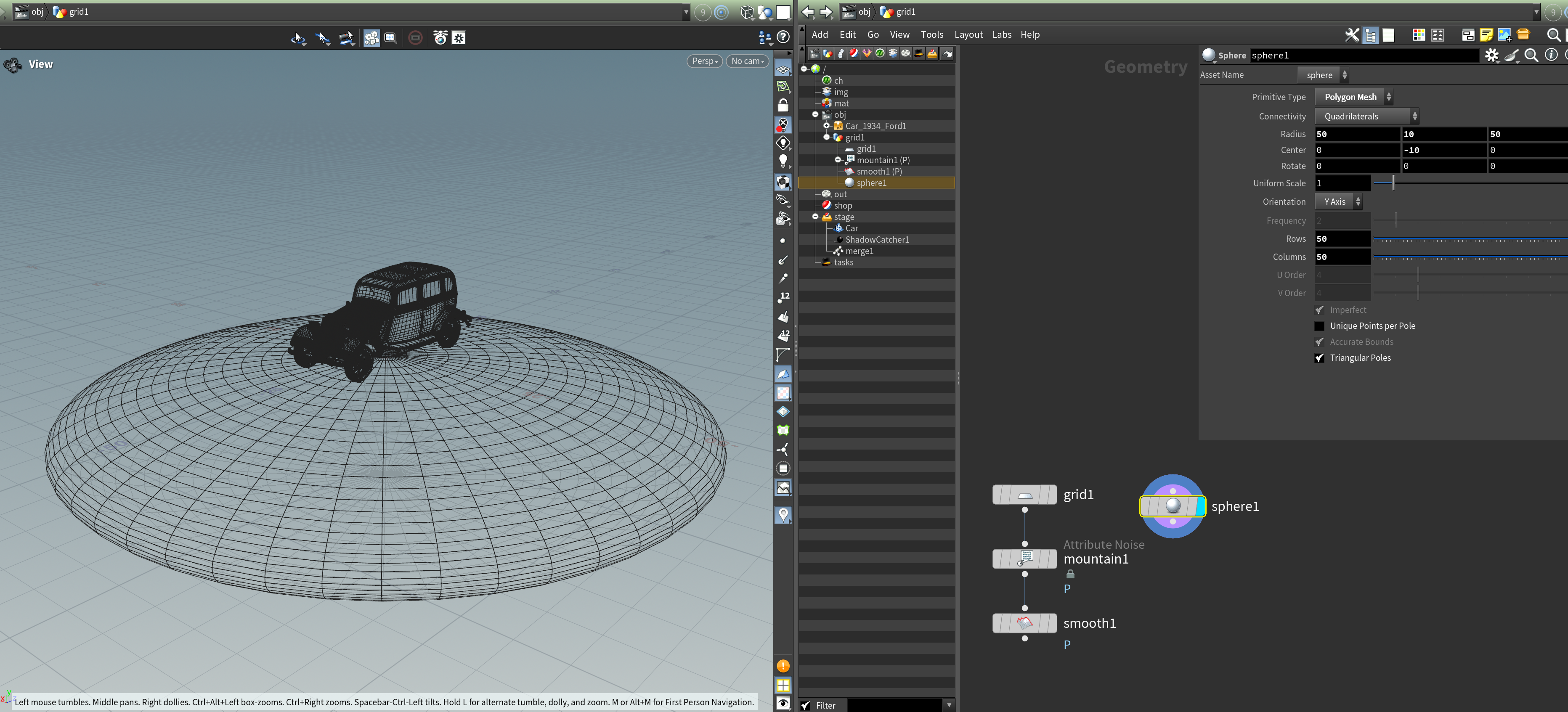

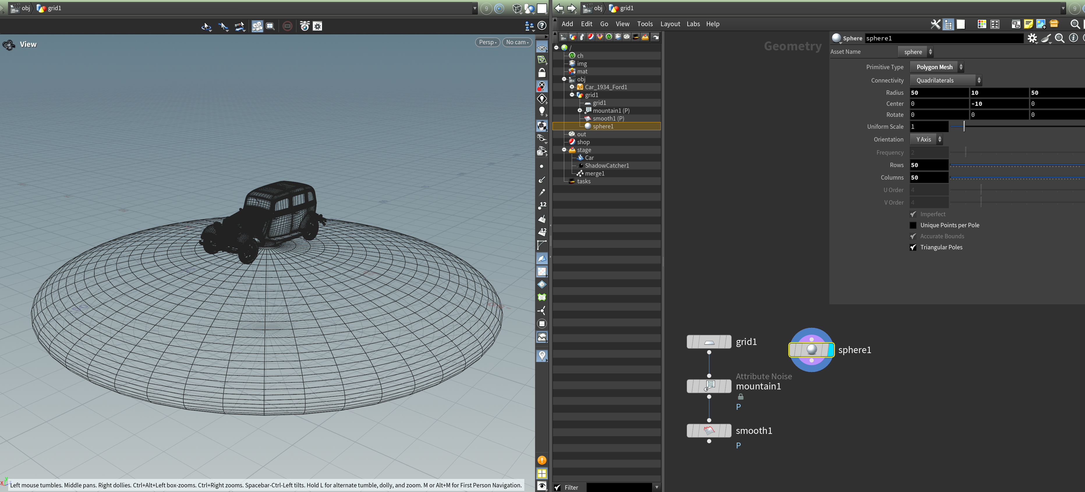

"All you need is a Grid to catch the Shadows, an Environment image (eg. HDRI) to cast the rays and Objects you want to cast Shadows from."
Just to check, catcher can only be grid or it can be any other object in the scene as well?
I mean wording seems a bit exclusive to grid so figured to check.

Catcher was designed on a Grid and the algorithm automatically trims up the Grid like trimming off fat from a piece of steak, but, I created a sphere Radius 50x10x50 Center 0x-10x0 with Rows/Columns = 50 and used it instead of the Grid and it worked, as you can see, the underside of the squashed sphere also catches the Shadow, I don't think it would be a good idea to have a 3D object catching the Shadows, but a 2D object (without a bottom) would be fine:
