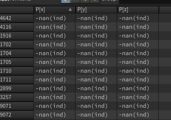

After remeshing an object, the P attribute shows -nan(ind). I tried to compute normal and the same thing happened to N. How do I fix that?

Did you use Remesh Sop ?
Sometimes it could produce zero area primitives and these NaN values might be related to it.
It might be a bug, or even something related to the source geometry.
I would like to see an example file showcasing your issue.
Could you upload the file, please?

Here's my hip file.

I had a look, but It's not clear where the error is occurring.
Which node is causing problems?

I wrote a commet. It's the remesh2 sop near "Try to deleting weird points". That node shows weird P attributes. And if you add a normal sop, the same thing will happen to N.

That's weird, I can't find any Remesh Sop node in any of the geometry object in your project file.
I even used to the Find Tool, but no success in locating it.

ps, have a look at the changelog for 12 Nov:
Remesh Sop was updated and some NaNs related bugs fixed in 19.0.437
https://www.sidefx.com/changelog/?journal=19.0&categories=&body=remesh&version=19.0&build_0=383&build_1=455&show_versions=on&show_compatibility=on&items_per_page= [www.sidefx.com]
One tip: for heavy remeshing tasks, you can really save a lot of cooking time by using the multithreaded Fast Remesh Sop
https://www.sidefx.com/forum/topic/80497/#post-348623 [www.sidefx.com]

it's ok, I converted it into vdb and converted back, It should work.

Oh, I made a mistake, I uploaded the wrong file... I'm sorry
