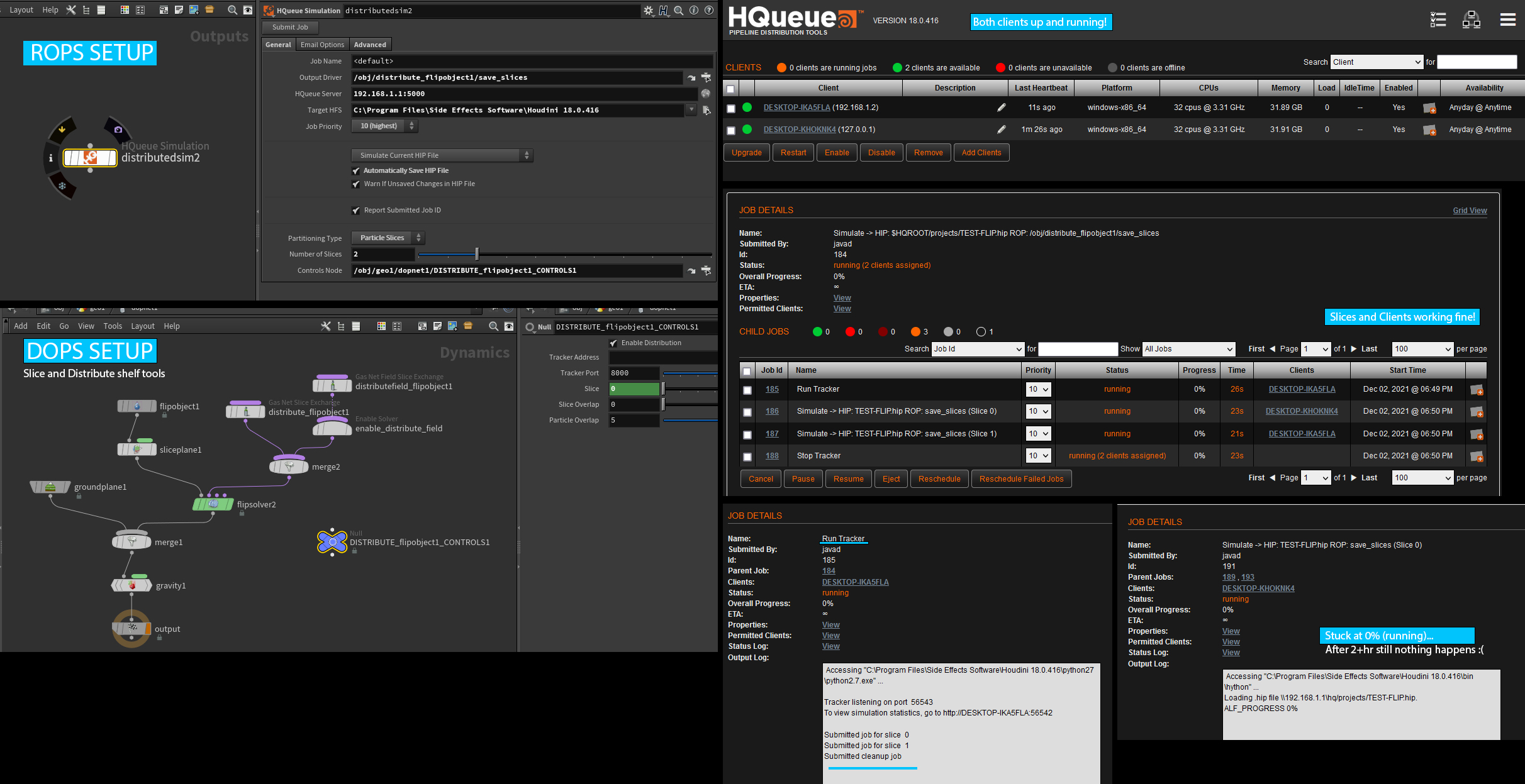

I have 2PCs that is setup correctly with HQueue! HQueue render works fine, also Simulation with no slices work fine, but as soon as I use slice and distribute shelf tools for FLIP and send it to HQueue job doesn't start working, it stuck at 0%, I attached the screenshot! does anybody know what could be the problem?

This could be a firewall problem.
I had the same thing until I read this post:
https://www.sidefx.com/forum/topic/37431/ [www.sidefx.com]
As Jeff Lait said:
"The client-to-client communication also allocates a port at run time. There are no fixed set of ports to open between the machines. There needs to be no firewall/shorewall between the machines that are simulating, or between them and the tracker. There MUST, of course, be a firewall between your machines and the rest of the internet!"

I temporary turned off firewall on both machines and now its working! Thanks for the tip! but my new problem is that its not faster simulating on a single machine! its even slower! Did I fundamentally understood something wrong, Slicing going to simulate slices in parallel or one machine always going to wait for another machine to response?
